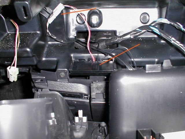

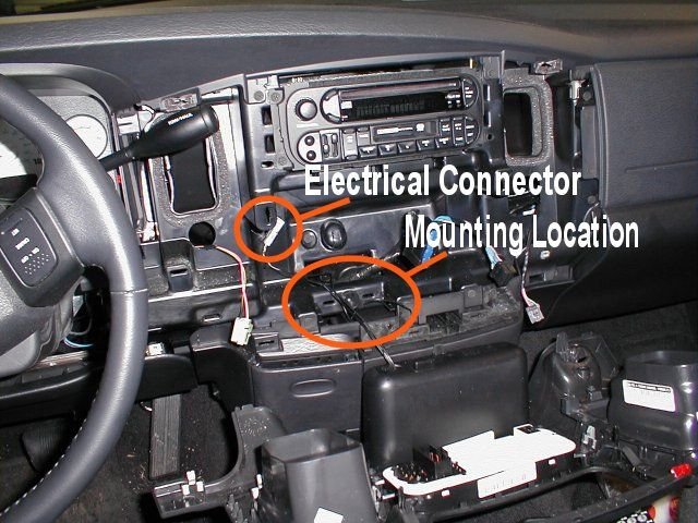

Originally Posted by AnotheRam
Is there a way to add a light by my cup holder on my 02 ram. I have almost missed the cup holder a couple times at night trying to watch the road and set my drink down
Pull your center bezel, you MIGHT find the harness for the factory option courtesy light there. Came with the light group in 3rd gens. I have a link to an install thread but it's on another forum and I don't think they like links to other forums here. Here are the pics, p/n is 55361226AA.
