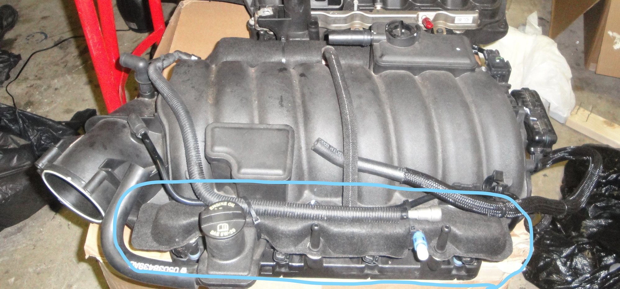

I have a 2002 Dak with the 4.7, my goals are purely daily driver experience + mpg (thread going in the 2nd gen dak forum if interested). so far the best bang for the buck was to wrap the fuel rail (see pic for info). Tested the exhaust wrap with a heat gun & sheet metal and if effectively blocked heat transfer as is out of the package. Fairly easy to install w/o pulling the rail. Air_Ram claims its good for 10 hp. I've been doing it since 2002 or so and almost every time (the 2000 5.9 magnum Ram - ~6% better mpg's from it + fuel cooler), positive results that can be felt.
Have since added a 70mm TB (well worth it) and an Airaid MIT between stock airbox & TB. HP Tuners custom tuning (by me) coming soon...
Probably why the 392 comes with it from the factory
