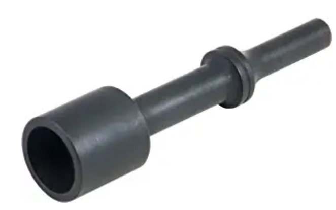

I couldn't get back to it yesterday, probably today after work I'll give it another shot with someone else turning the wheel so I can watch what is going on. Decided to order one of these air chisel bits today. It will arrive tomorrow...

I've lived in the rust belt all my life... so yeah, I've got the universal BFH too - all 5 lbs of it. I hit it so much the bearing started to separate - not good... so I had to stop trying hat method.
Got back to it a little tonight, that lisle #39250 impact hammer chisel is doing its job. Started to back off slowly, but after less than a minute of agitation, I could see the hub mount slightly back off the knuckle. Had to stop and find ear protection, that gets loud fast. I have some other things to do tonight, but have the next couple of days off ... so I'm thinking the next ugly job will be the ball joints.... I'm saving the pitman arm for last, the kit comes with a new one that is at a much different angle than the Y steering setup.
