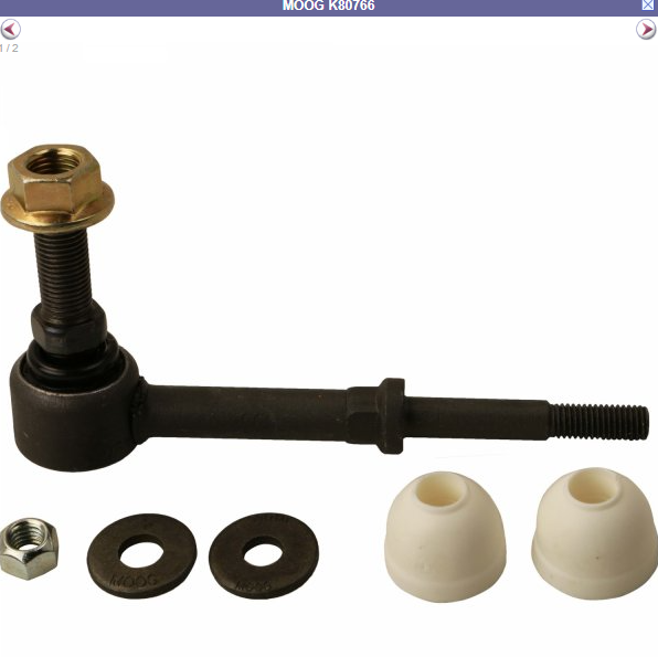

I'm installing Moog sway bar links part# K80766 on my 2006 ram 2500 and I got the drivers side in no problem. But I can't get the right side in. The bottom bolt on the link won't go in all the way through the hole, maybe a quarter way then it seems like the bolt is too big. I double triple checked the part numbers and they are the right links. I don't get it.

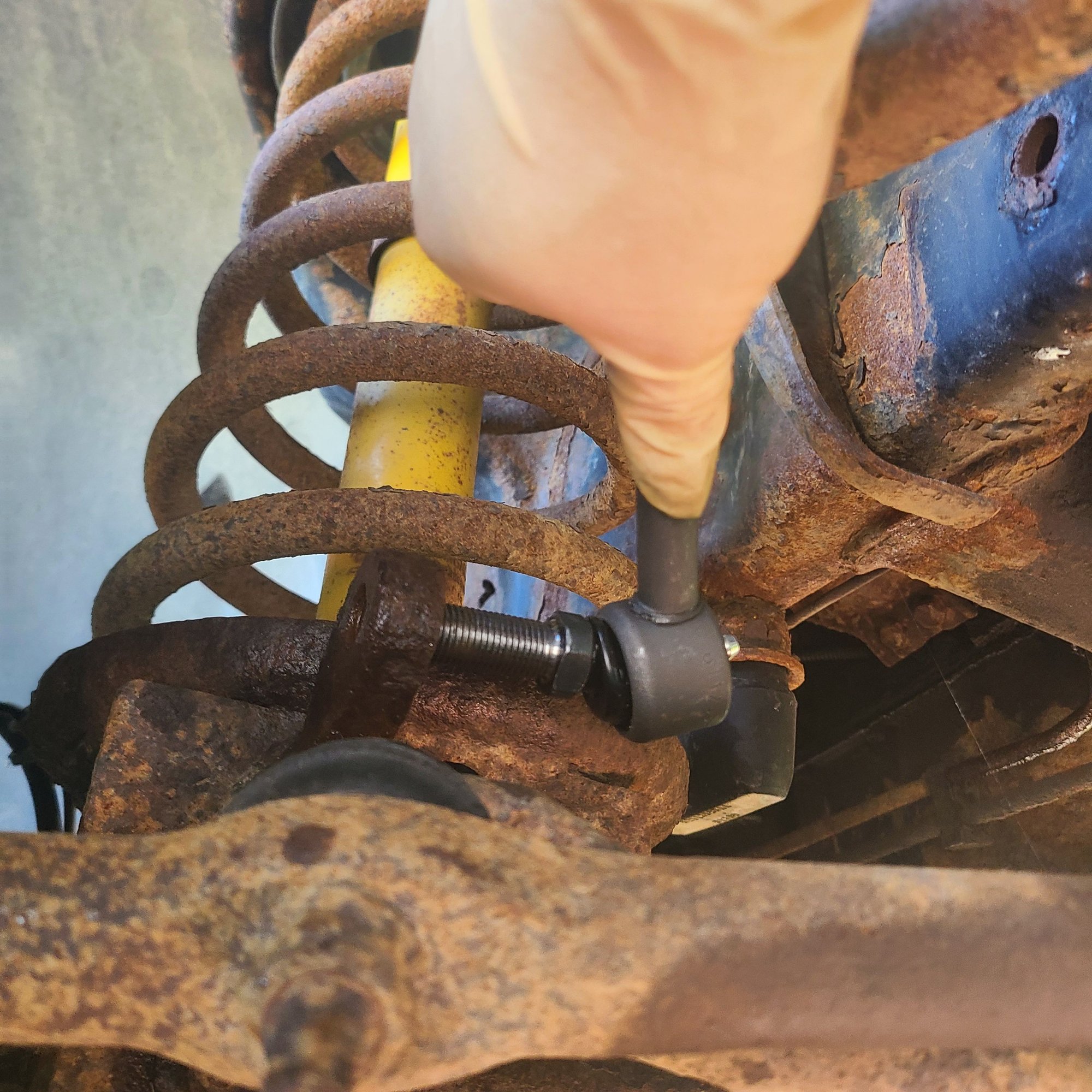

Its the hole in the frame that it wont fit, the thicker bolt on the link goes through it. I did find it odd that the side I'm having trouble with didn't have a link at all. I just purchased the truck the other day. But the hole seems to be cleared. I even used some kroil to lubricate the hole and bolt to help it in but not luck. I tried hitting it not too hard with a rubber mallet to push it in but no luck either, I didn't want to him it too hard and mess up the grease fittings. I also didn't want to try and force it in too hard, so I wouldn't ruin the threads on the bolt.
Old Jul 2, 2022 | 10:06 PM
ryangtp89's Avatar
ryangtp89
Posts: 7
About as far as it will go in.

Here are 3 ideas...
You could take the old one from the other side (since that side was missing) and use that to open it up, smack it in and out with a hammer to remove the obstruction.
You could measure the shaft and get a matching bolt and work that bolt through there with a hammer to remove the obstruction.
You could measure the shaft and then get a matching drill bit and chase the hole with that.
