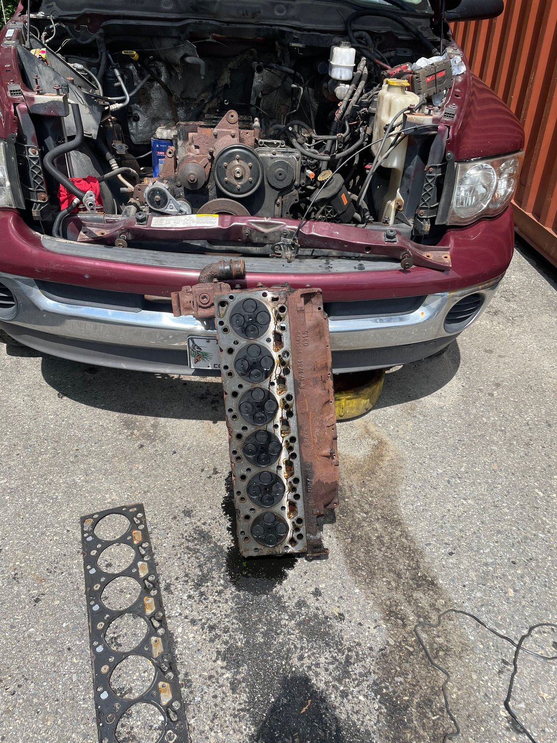

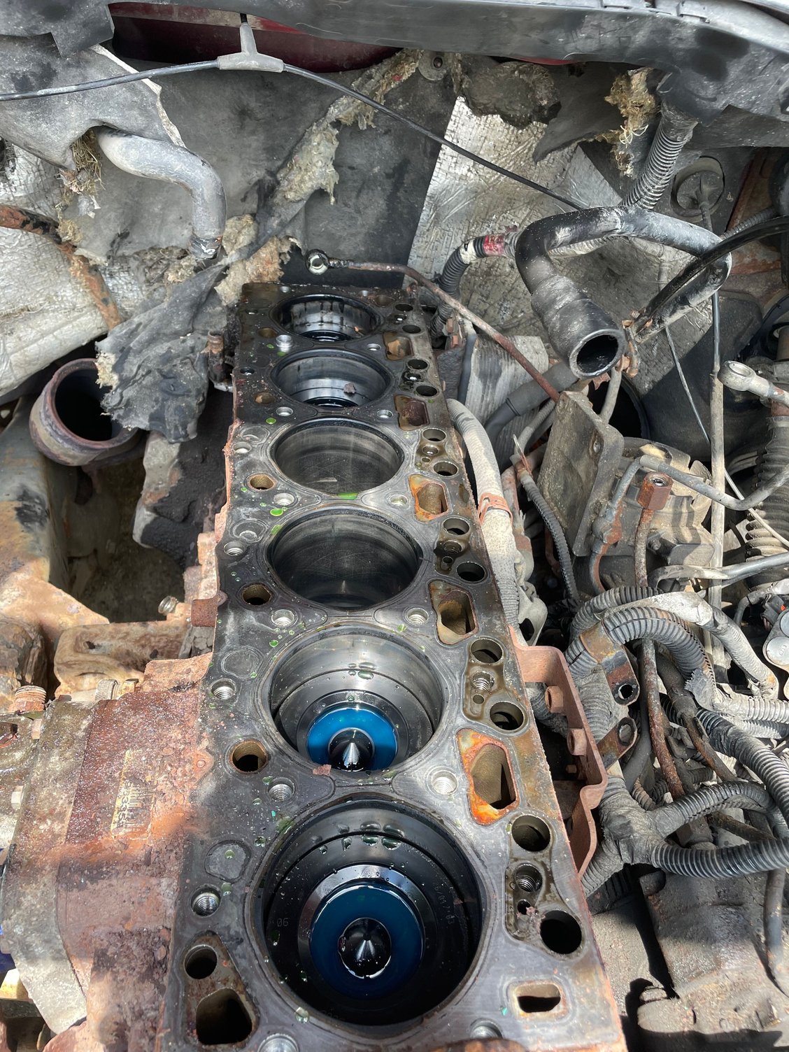

couple shots I took on one I’m doing…..this is for our office lady’s husband so it’s no rush which is why I’m doing it outside so I don’t hold a bay up in my shop.
only about 3 1/2-4 hours into it and heads off…be careful thing weighs a ton and awkward to get out of your doing it solo.

Figured I’d post to prove my point that the crossmember in front does not need to be removed……took me a total of 6 hours to pull engine, on ground….didn’t want to tie up a bay in my shop cuz now I’m going to remove crank, pistons etc and have them sent out……this 03 Cummins had 356k…broke a piston ring but owner wants full rebuild…..EVERYTHING came apart easy and all the bolts were rusted.
