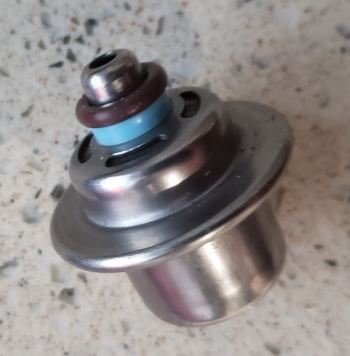

"it has a one way valve that wont let the gas go in the opposite direction"... isn't that the check valve? Do you have a pic if that? Just curious to see where it lives. I've seen where someone splices another valve into the rubber gas line, nearest to the tank. Not that I would do that... my pump has lived ten lives. LOL

The check valve is build into the pump, but thats what it looks like.
