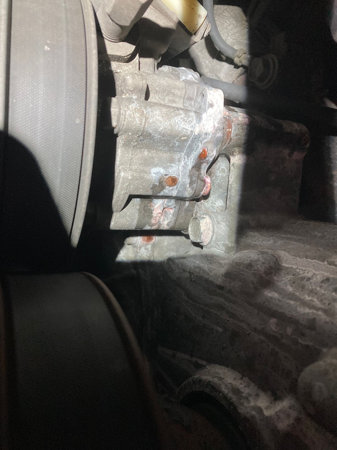

Went to change oil & filter, got underneath-saw orange-ish fluid. Pics from top & bottom:
Top
Bottom
The hose does not feel wet or any drips where it attaches. Is this likely a water pump? Thanks guys.

Yep, water pump has a weep hole that will start to leak as the seal wears.
I recommend you replace the coolant, radiator hoses, and thermostat while you've got it apart.

You'd be ok to drive the truck. Be sure to keep the overflow tank full. You may start to notice puddles under the truck.
The weephole is usually on the top side of pump, closer to the pulley than the block.
Coolant really lights up under black/UV light. A cheap flashlight will do.
