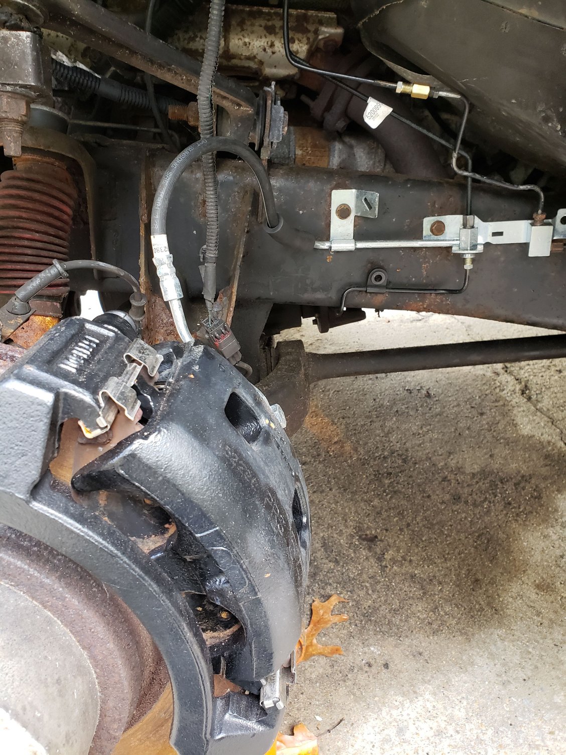

Default Picture Bleeder Screw
Replaced brake lines bracket
Bleeder screw facing rear

Caliper is on the wrong side of the truck. You will never get the air out of that.

Yep, there is air in upper half of brake caliper.

Yep, wrong side.
