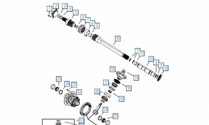

Hello everyone, I'm new to here. I have an issue and am having a hard time find a resolution through google and whatnot, so I'm asking for some advice on here. My 4x4 wouldn't engage, so I figured that the front axle actuator was shot. I was replacing the actuator and realized that the axle disconnect collar (#7) is seized onto the intermediate shaft (#10). I was wondering what you would have to do to get that freed up and what replacement parts would be necessary to buy. Thanks for any help.

Hit it wih some chems (PB Blaster is my favorite) and try and tap it over with a hammer. If you can get it freed up, just clean it REALLY well, make sure it moves smoothly by hand, and lube it up, and reassemble. (replace any seals while you are there.)

Thank you for the reply. I forgot to mention that there's some metal shavings in the CAD housing, about 1/4 inch long. I was thinking maybe the splines for the collar (or maybe even intermediate shaft) are possibly toast. With the truck in 2wd, the driveshaft to the front diff spins the intermediate shaft and collar smoothly without any noise or hesitation. I was thinking of getting a new intermediate shaft, collar and any bearings/ seals that need to be replaced in case they're shot. I dont want to tear into it without the necessary parts either since I drive it daily. With that being said, I dont know where to start with the removal of the intermediate shaft either. Thanks again
