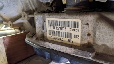

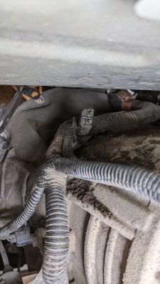

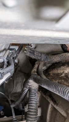

Hi all,
I have a 2005 Ram 3500 DRW 2WD automatic with the (I think) 45RFE [DGQ] transmission.
While working on the rear output seal, I noticed what I think is an electrical connector that may have pulled out from somewhere, but I have no idea where/what it is.
It's on the top, near the front, at about the 00:30-01:00 o'clock position as viewed from the front (the pics are from the rear looking forward). Transmission tag included, in case that helps.
Any assistance with identification would be appreciated. I think it's been disconnected a while, as it was covered with a buildup of dust and dirt. There weren't any CEL codes or strange behavior prior to noticing this.
Thanks
Transmission tag
Unknown connector with two green rubber (?) ends
Another view of the unknown connector

It's a blank connector. it's so the mating connector doesn't get full of crap.

Magnoom,
Excellent, thank you!
I was hoping it was something like that. I just haven't come across a cap with the green looking rubber on the end before.
