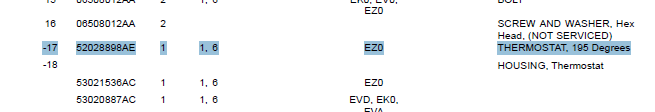

Well. After some research, here's where things get interesting. P/n for your specific OEM 'stat is 52028898AE. In the factory parts book it says:
However EVERY online search listing for that part number that I have found comes back with 203°. I still have the stock 'stat in my 2003 (same p/n). I have an actual temp gauge hooked up and in the summer it's usually between 199° and 205° depending on ambient temp and speed (I have a hood scoop so that tends to aid in cooling). Towing (especially when it's hot) I generally see it even higher than that (depending on weight).
I realize that probably doesn't help at all, just the information I have to share.
