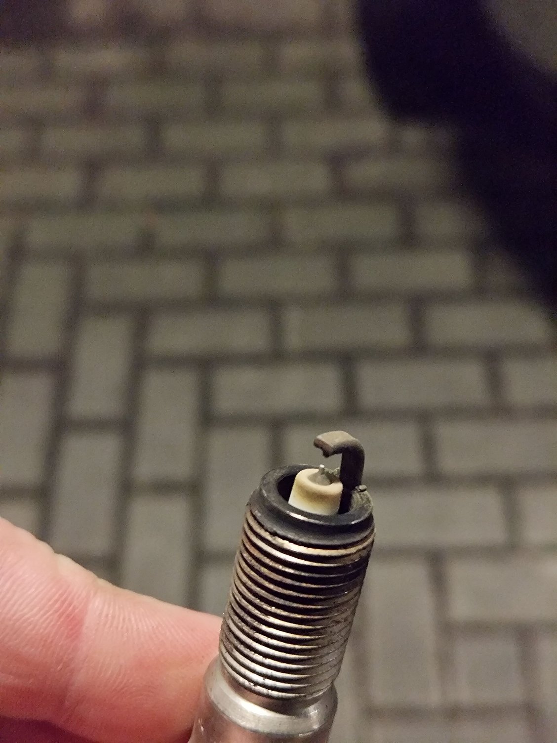

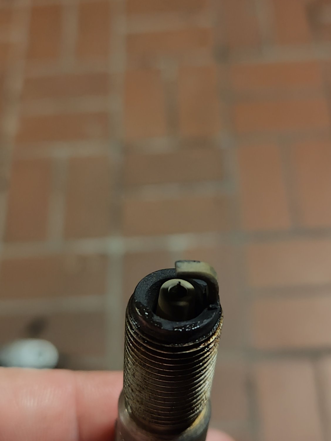

One plug had very slightly oil on the threads, the other looked fine.
​Maybe a little bit lighter/more white than usual but that might be due to the LPG.
I can take some pictures of them.

EDIT: The spark plugs that are in there are "Denso ITL16TT", so it seems these are "Iridium" spark plugs? Might these really be the cause for the error? Should I change them over for the stock Champion / NGK copper ones?
Here are the pictures from the spark plugs. Please note that I took the pictures a few hours after removing them, the oil was on the thread only and really not much.

Oil on plug threads could be because plug was not torqued properly, or, oil is getting past the spark plug gasket. You may need a new spark plug gasket.
A bad PCV can also cause oil in the spark plug tunnel.
Did you notice oil on your socket when removing the plug?

No, there was no oil on the socket. Also the coil plug was looking clean without oil.
