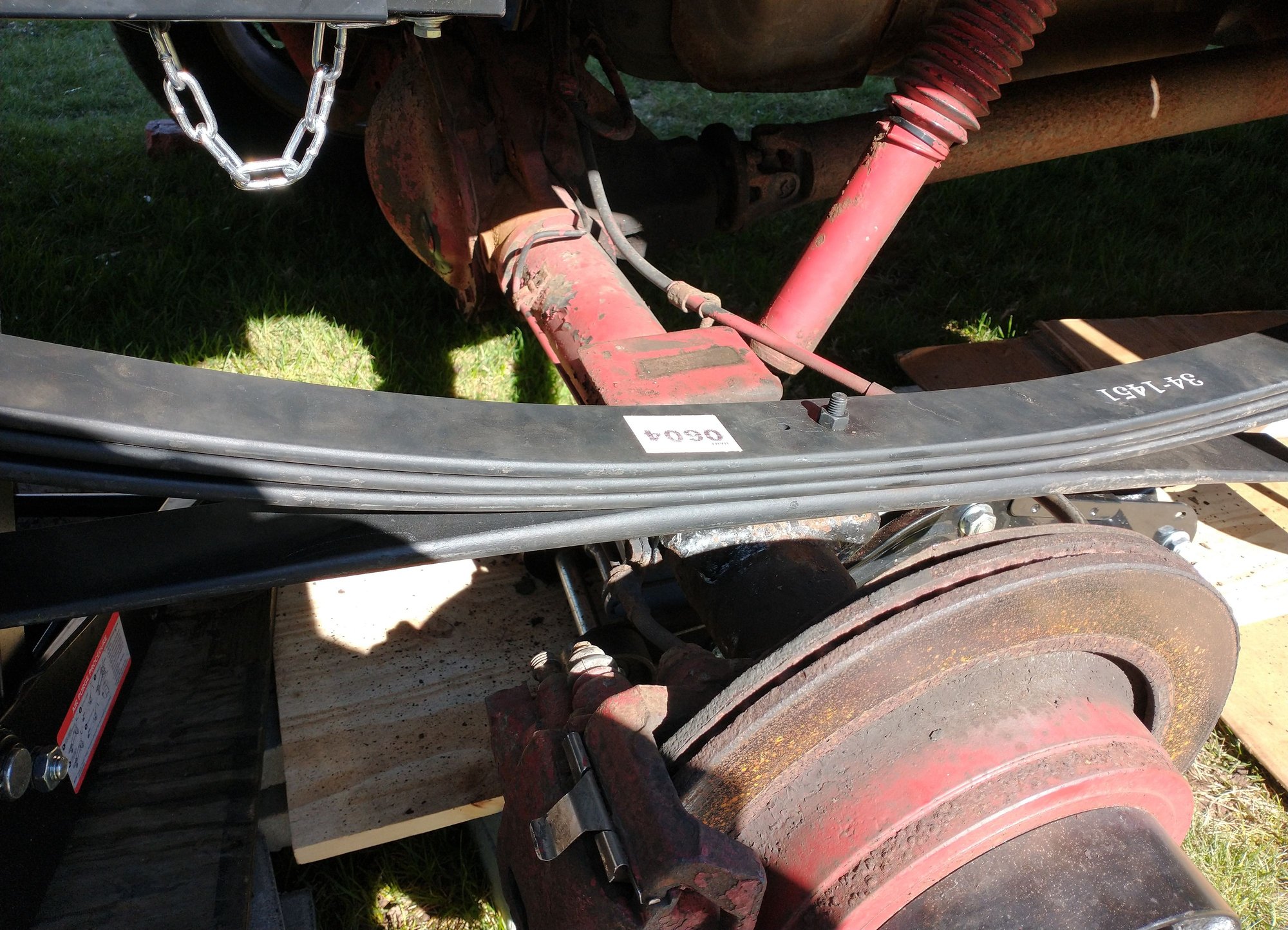

So had some issues with install... Do you know which way the leaf springs are supposed to face? The leaf springs I removed didn't have the buckle on it so not sure if it's supposed to be orientated to the front or rear.
I would've thought that it was supposed to be in the rear but I orientated the leaf spring based on the location of the bolt and hole in the center. I set them up the same way as the ones I removed.

In the leaf springs current orientation (as pictured) each end attached fine yet the center bolt is off and I couldn't get it aligned on the axle.
I took the leaf pack off, switched which side the shackle was on and tried to reinstall. Center bolt was aligned on axle, shackle was attached, but I never attached the other end of the leaf spring b/c it was sitting on top of the exhaust tip and I was worried the hanger might snap if I aligned the bolt holes of the leaf spring + bracket. That didn't seem right so I ended up taking it out and switching the shackle back to it's current orientation (as pictured). I'm starting to think that maybe I shouldn't have switched it back and maybe put a jack under the shackle side of the spring to adjust the angle on the front end of the leaf spring so it wasn't sitting on the exhaust tip......🤷‍♂️

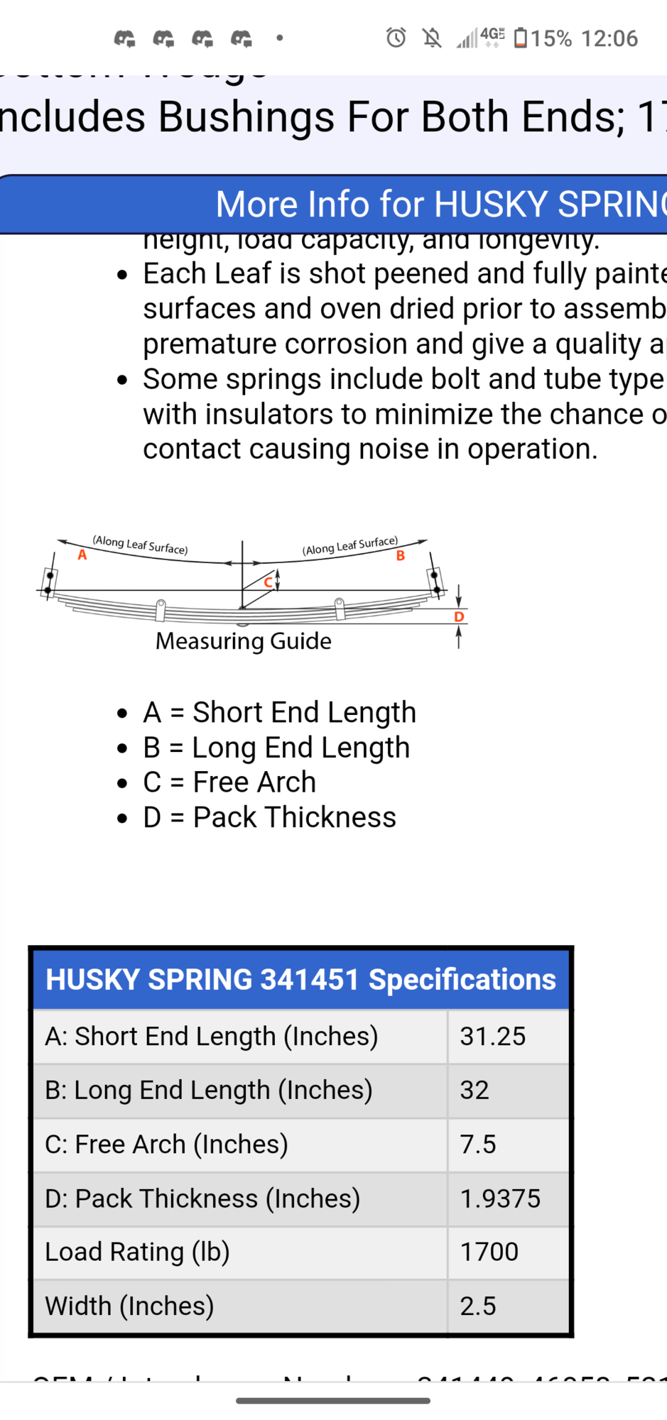

I looked at the spring specs and seems like 1 side is longer.

Got a better look at the old+new leaf springs and they were definitely installed in the correct orientation. I put the old leaf springs on the center aligning hole and the front bolt holes were off about .75"-1".
The new springs are off too. Therefore I was thinking that the axle probably moved a little. Im sure it doesn't help that is in grass either. I used an iron prybar to move the axle a little but I couldn't move it enough to get the pin on the leafs to drop.
@ this point I'm thinking about connecting the shackle + u bolts, torquing both 75%, and leaving the front unbolted, up against the bracket (maybe put in a little block of wood?). Do the same thing to the other side, then get it towed to a shop to have them attach the front bolts. Or connect both ends and leave the pack sitting on the axle & have shop install u- bolts. Just trying to think of the cheapest option if I do have to have someone else do it.
