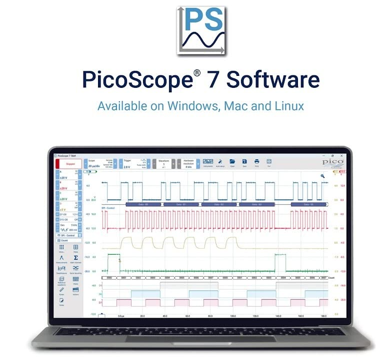

I'm always interested in tools that enable me to DIY, and this year I noticed that the scopes have really dropped into great price ranges. So I invested in a picoscope brand 2 channel scope that basically turns my laptop into a oscilloscope. Hantek has a cheaper alternative. I liked the picoscope software better, or I would have gone with Hantek.
