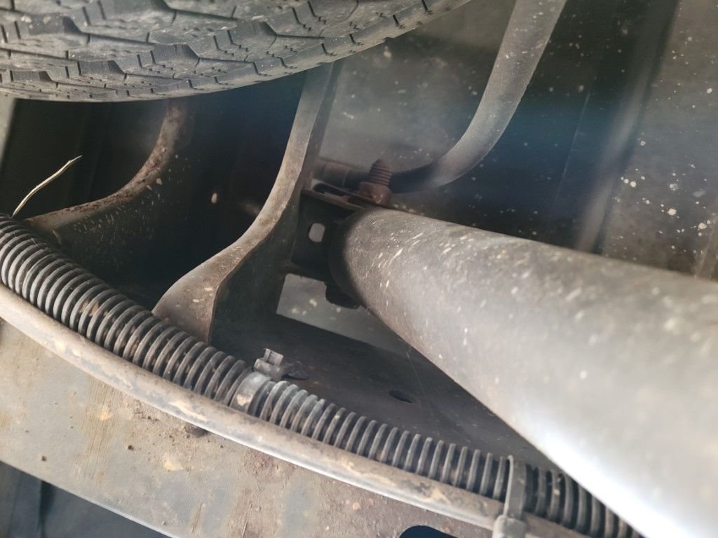

They have different mounts. Passenger side top of shock angles towards the front. Drivers side top angles towards the rear. Not the best picture.

Yeah I figure they could base the angle off the bottom mount on the axle.
