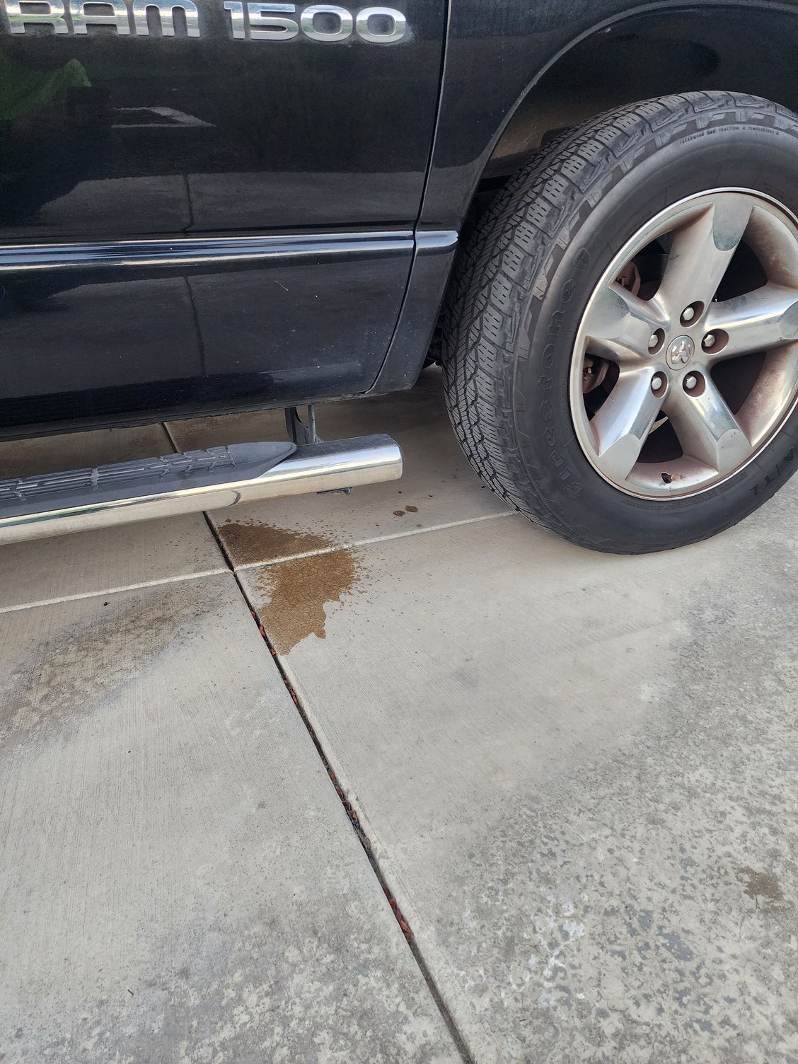

Alright. Quick draw trigger pull to disperse air bubble from AC recharge kit. Attached to Low Pressure on top dryer and moved needle 1/16 above if that. Truck was running at temperature and began to add 134a. After maybe 5min AC pumping very cold air and clutch was engaging how I remember. Ran for another 5min or so and saw the pictures below. Thanks for your advice and time. I feel like I know what the result and/or you reply may be. However I'm ready to handle this myself if you feel it can be done.
I tried to track condensation above front passenger wheel but didn't see anything as a source. I will be looking again tomorrow.

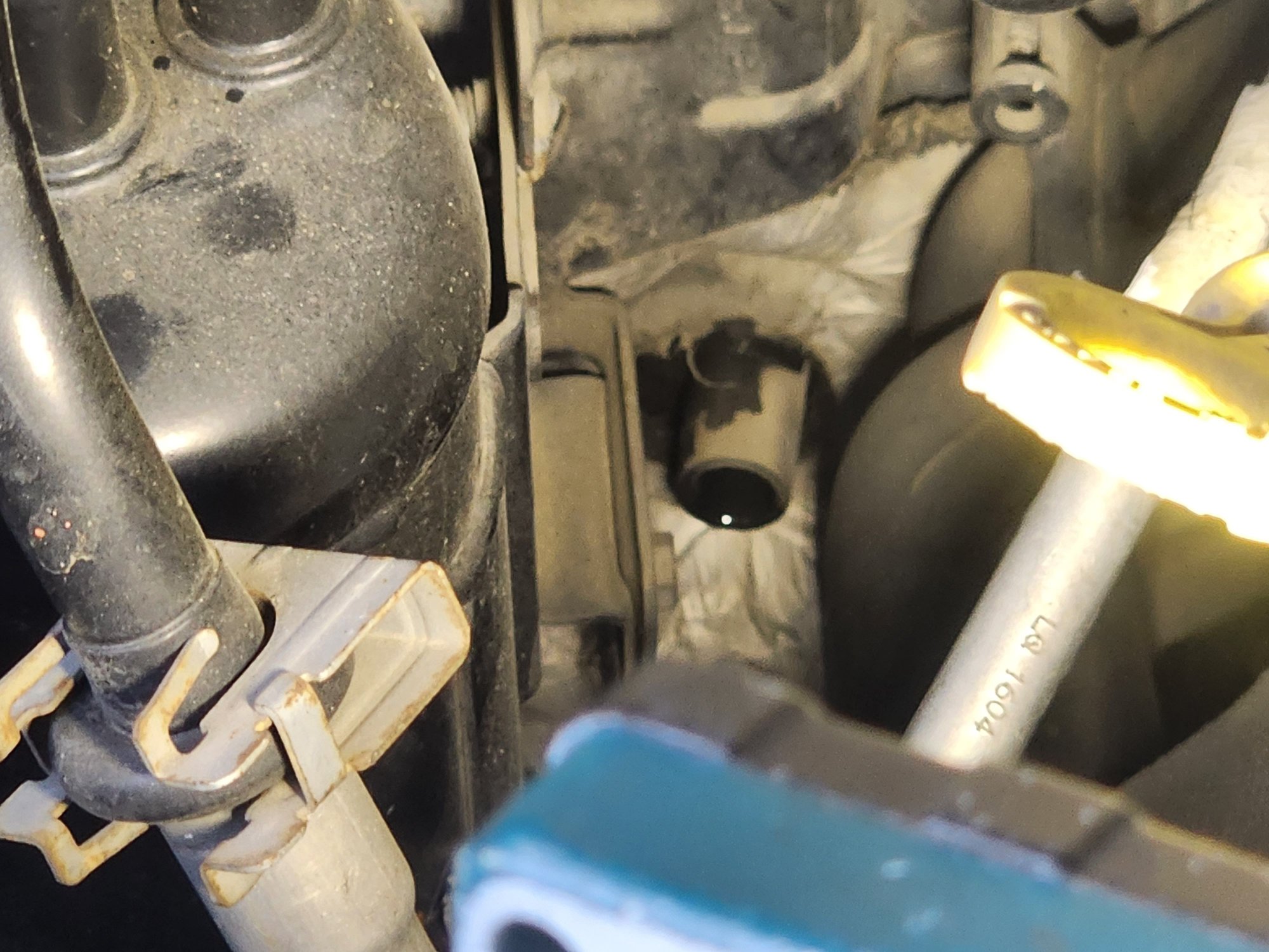

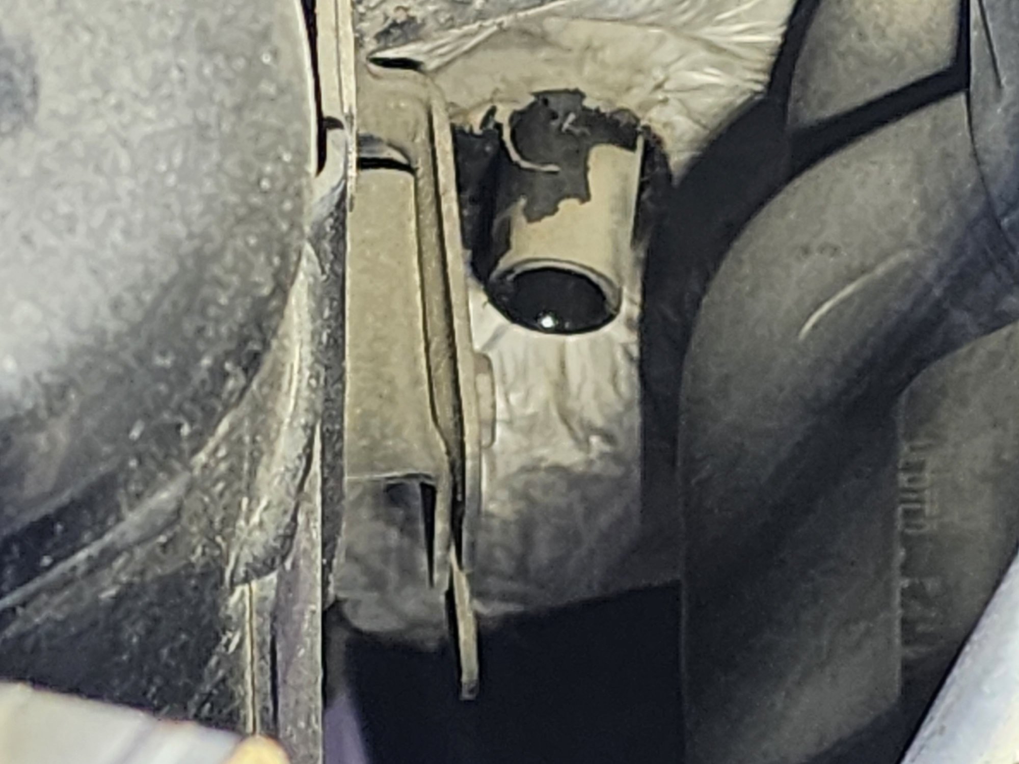

** also hit that condensate water on the ground with the UV light. does it glow?
All of the inside vent, defroster, heater, and condensate drain glow indicates a leaking evaporator core.
Also, if you smell a distink- smell, usually first thing in the morning after the car has been sealed up for a few hours, or after your shift at work.

Those last two pictures are the condensate drain, I suppose you know that but just wanted to make sure...
