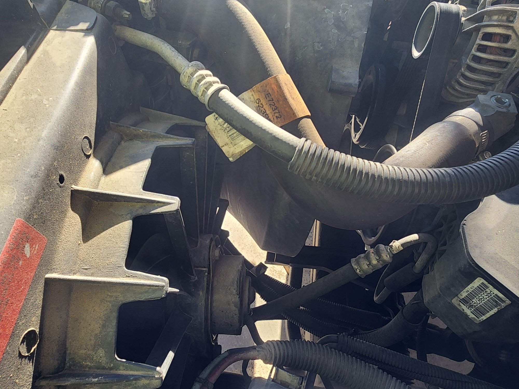

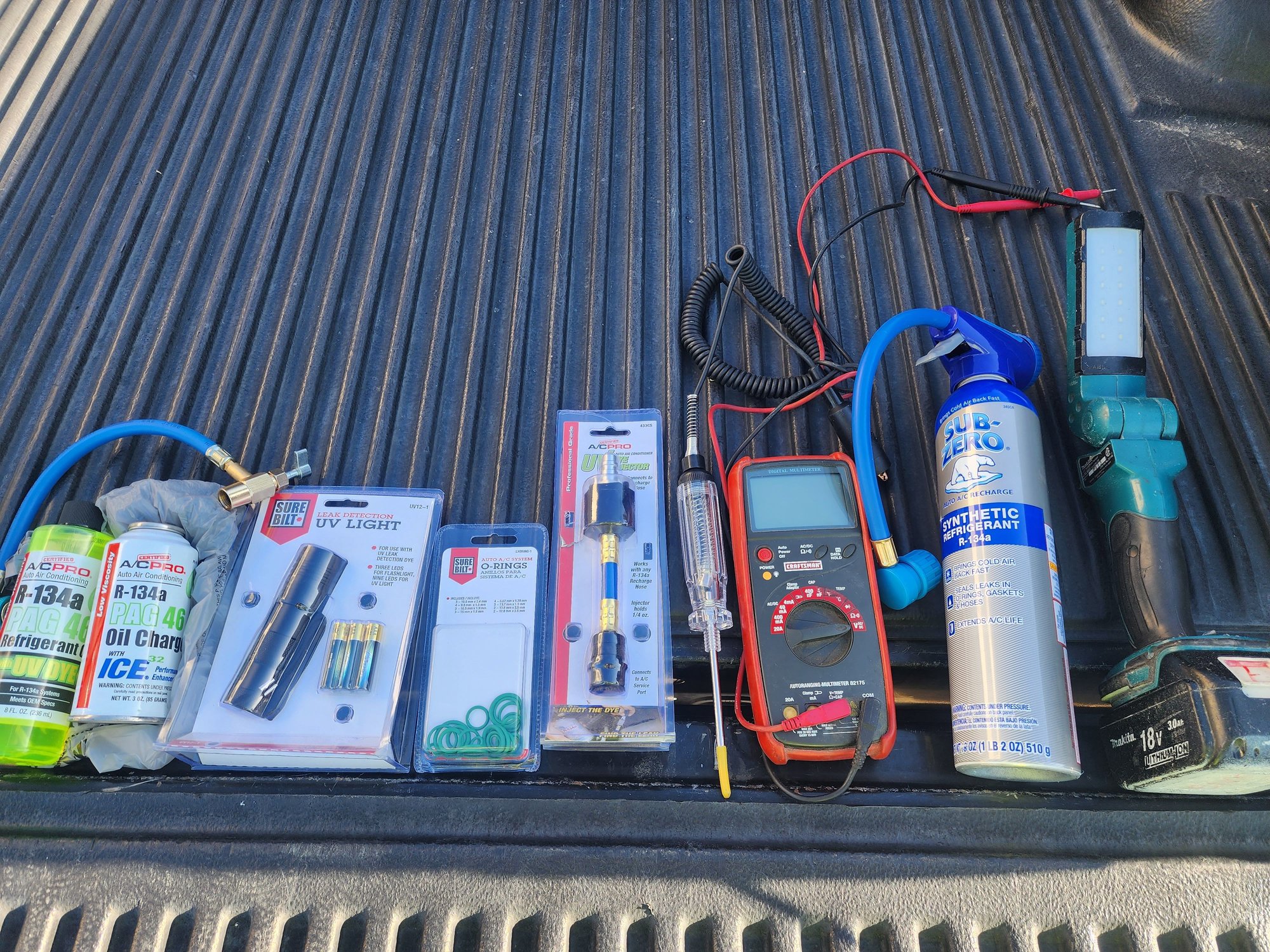

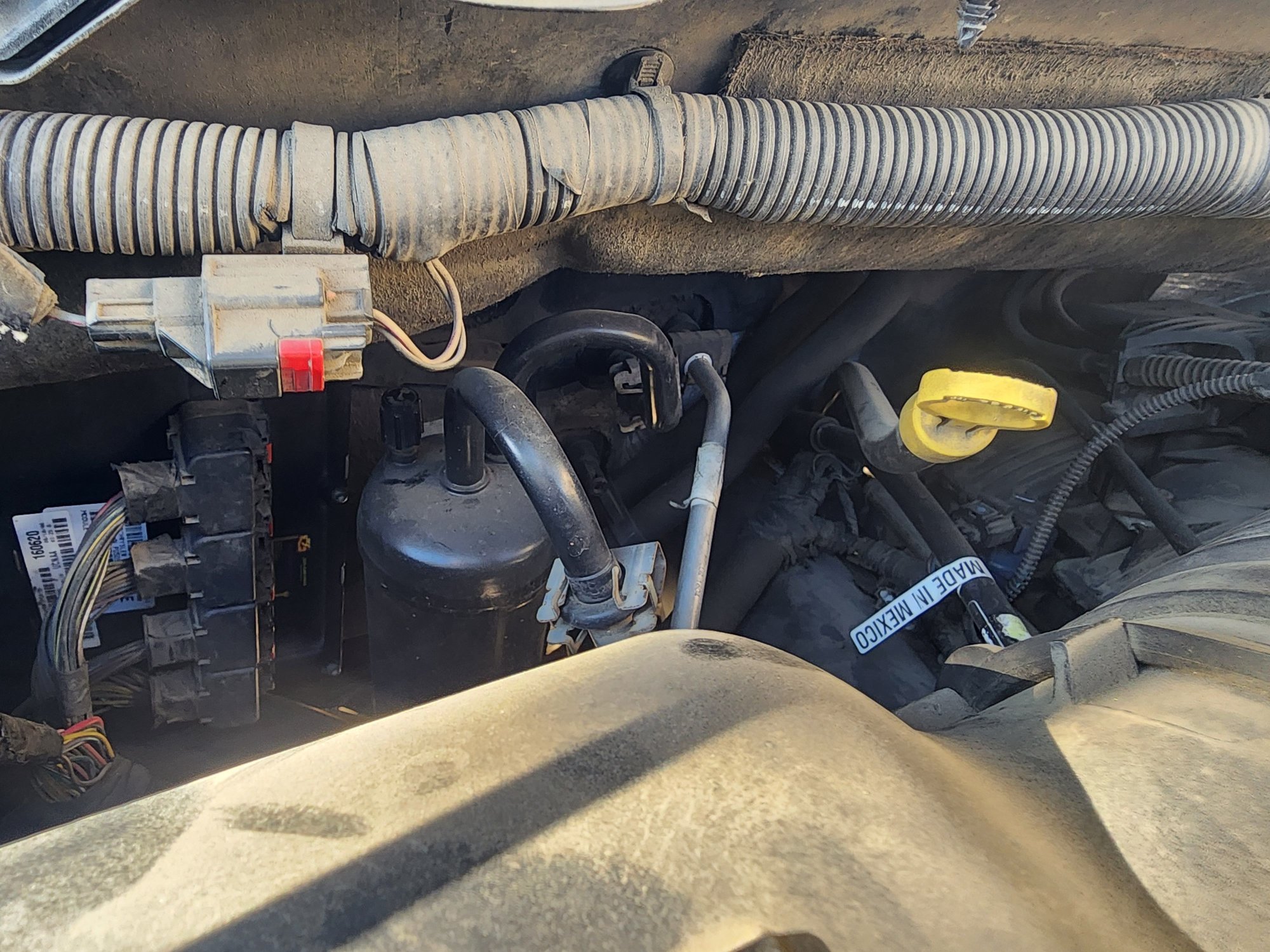

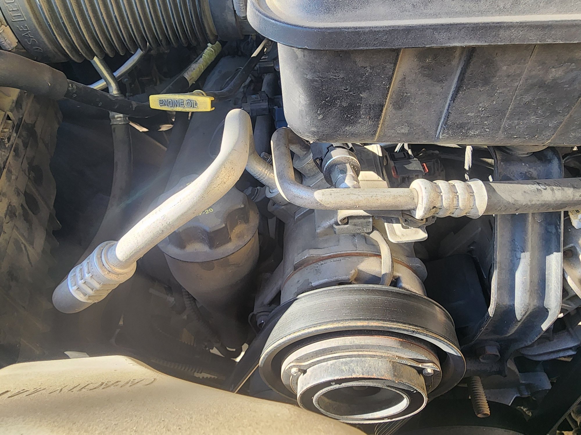

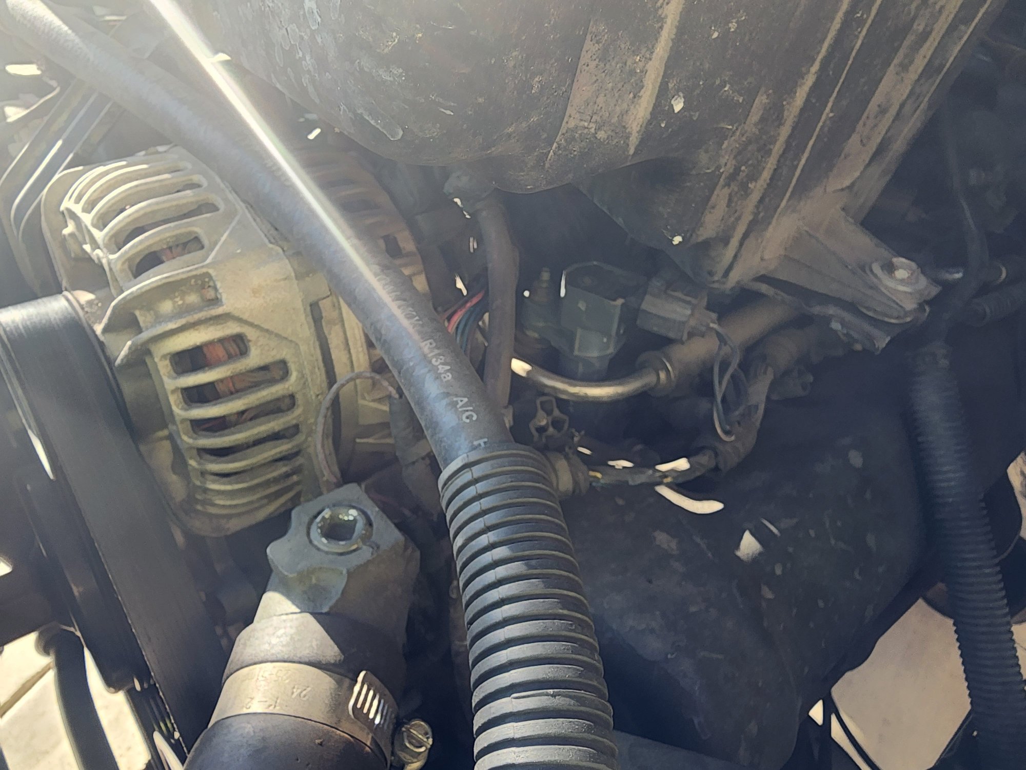

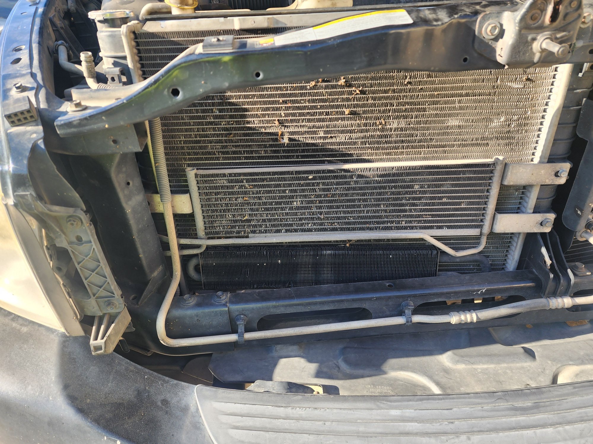

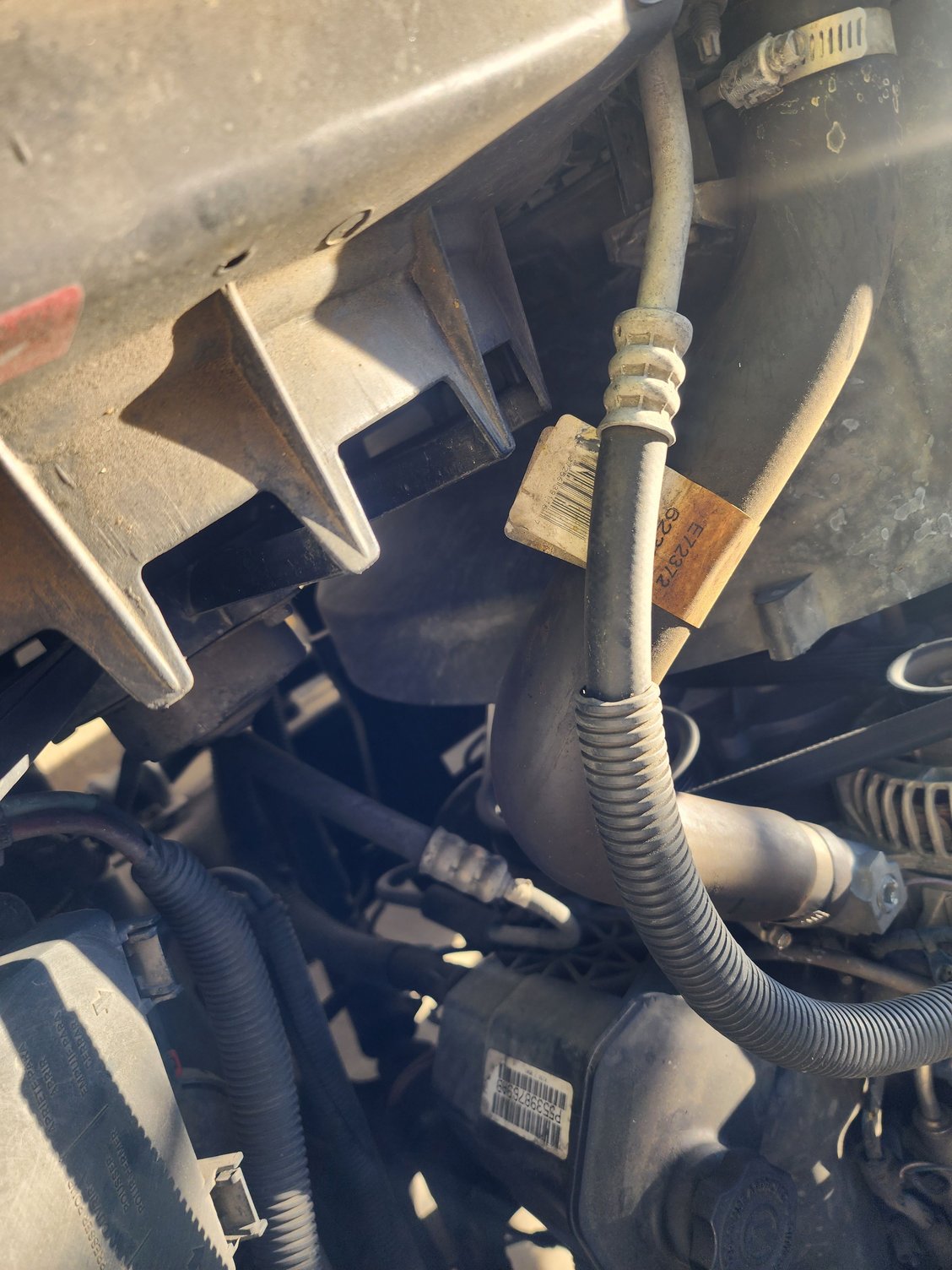

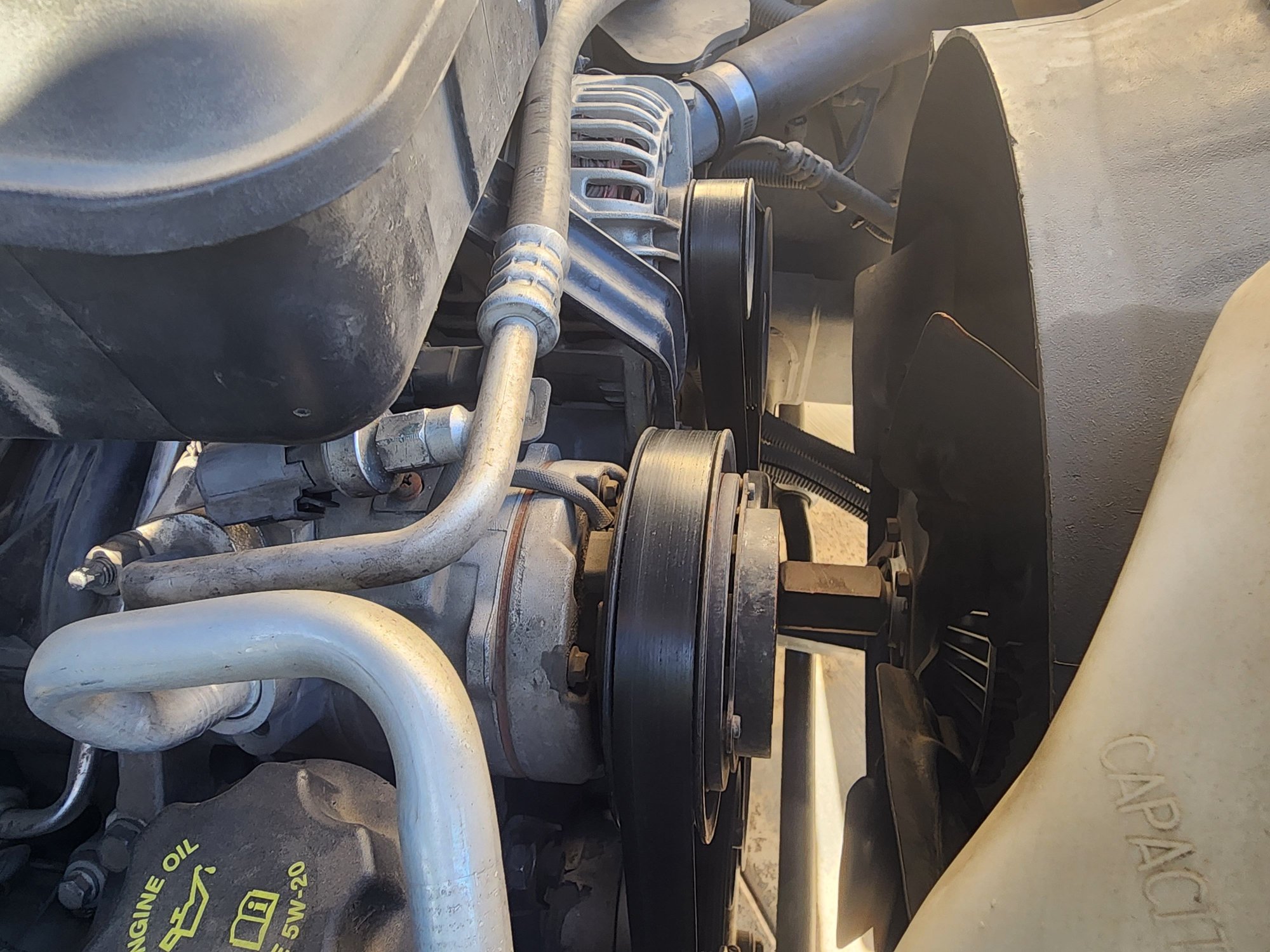

Some pictures
Not seeing build up as you described unless im overlooking
Would like to check fuses too if that helps
