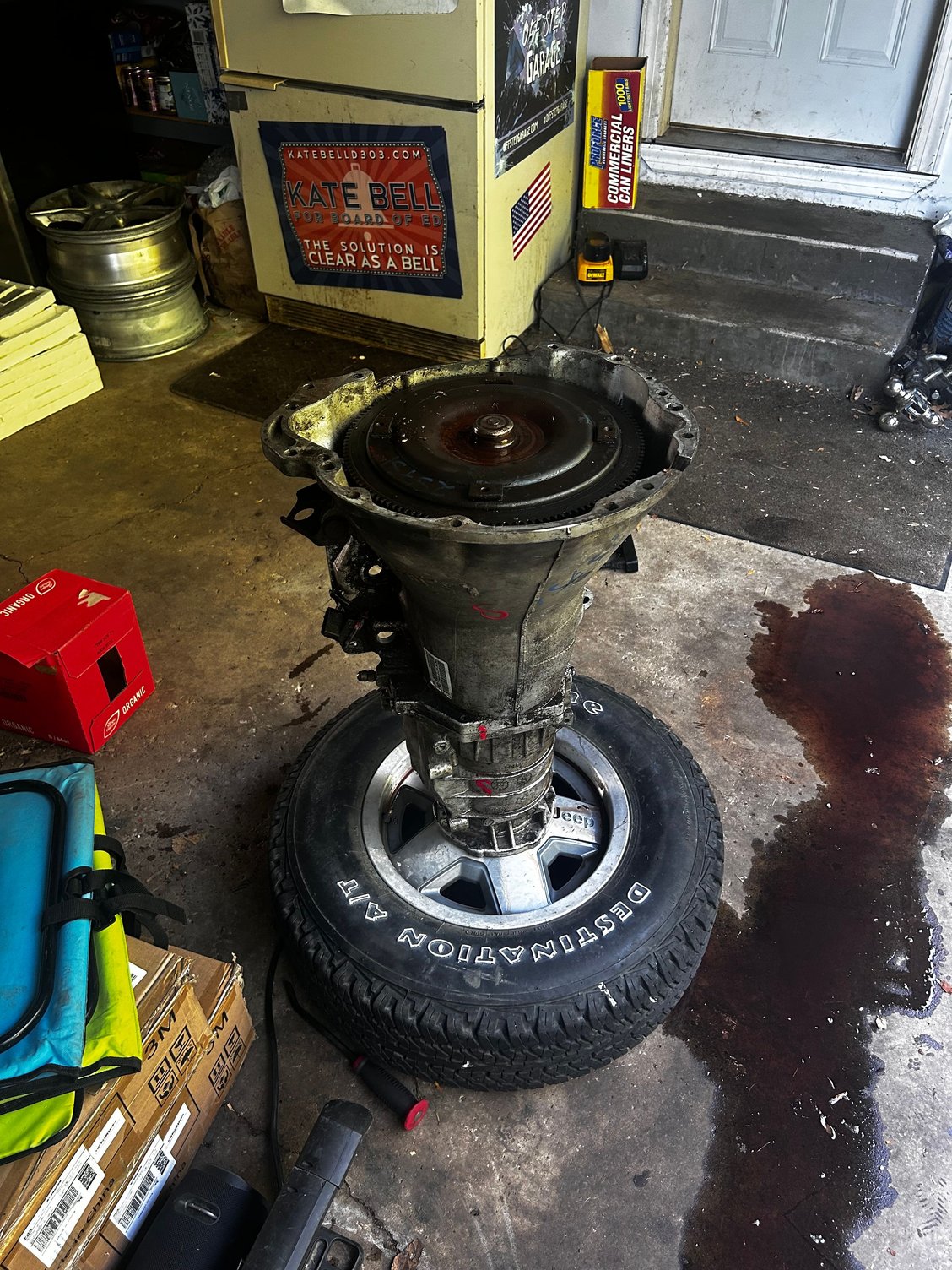

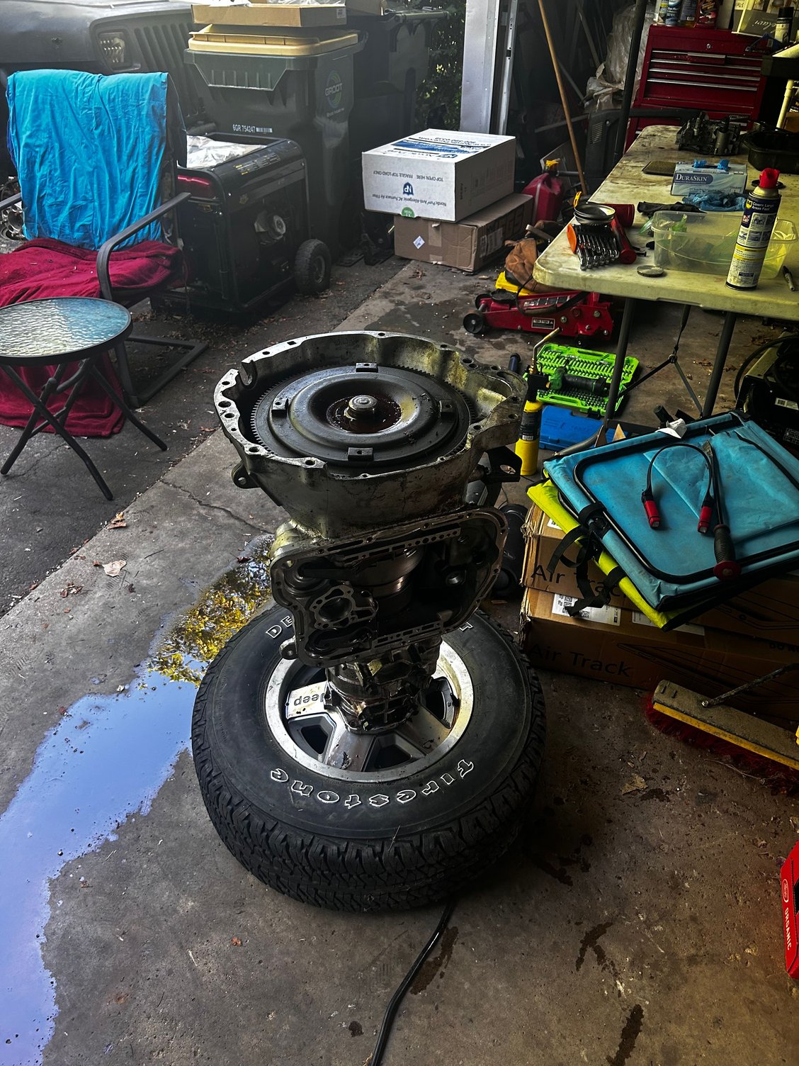

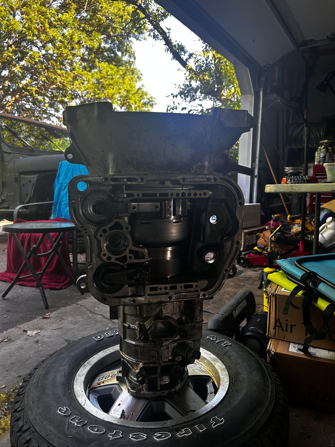

ADVICE ON REMOVING TC:
ive heard everywhere that you can easily remove the tc by wiggling back and forth while pulling up. well it wasnt budging. i tried everything. what i found worked for me was, if you rotate the tc, you can slide a thin towstrap under it. wrap it around the base like a cradle, and i hooked it to my cherrypicker. i lifted it and it lifted the whole trans xD. lifting by a half inch each time, making sure the trans was supported after, i hit the rim of the bellhousing down with a rubber mallet, pushing the trans down away from the tc and back onto my support. couole of these, the tc lifted out 👍. BE SURE YOU ARE NOT SUPPORTING THE TRANS ON THE OUTPUT SHAFT. i had an old rim and tire, the output shaft was through the center cap hole, the trans being supported by the housing on the rim. pics are of trans standing up.

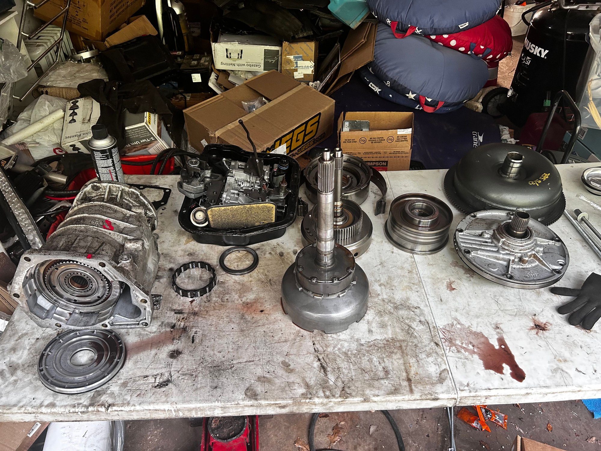

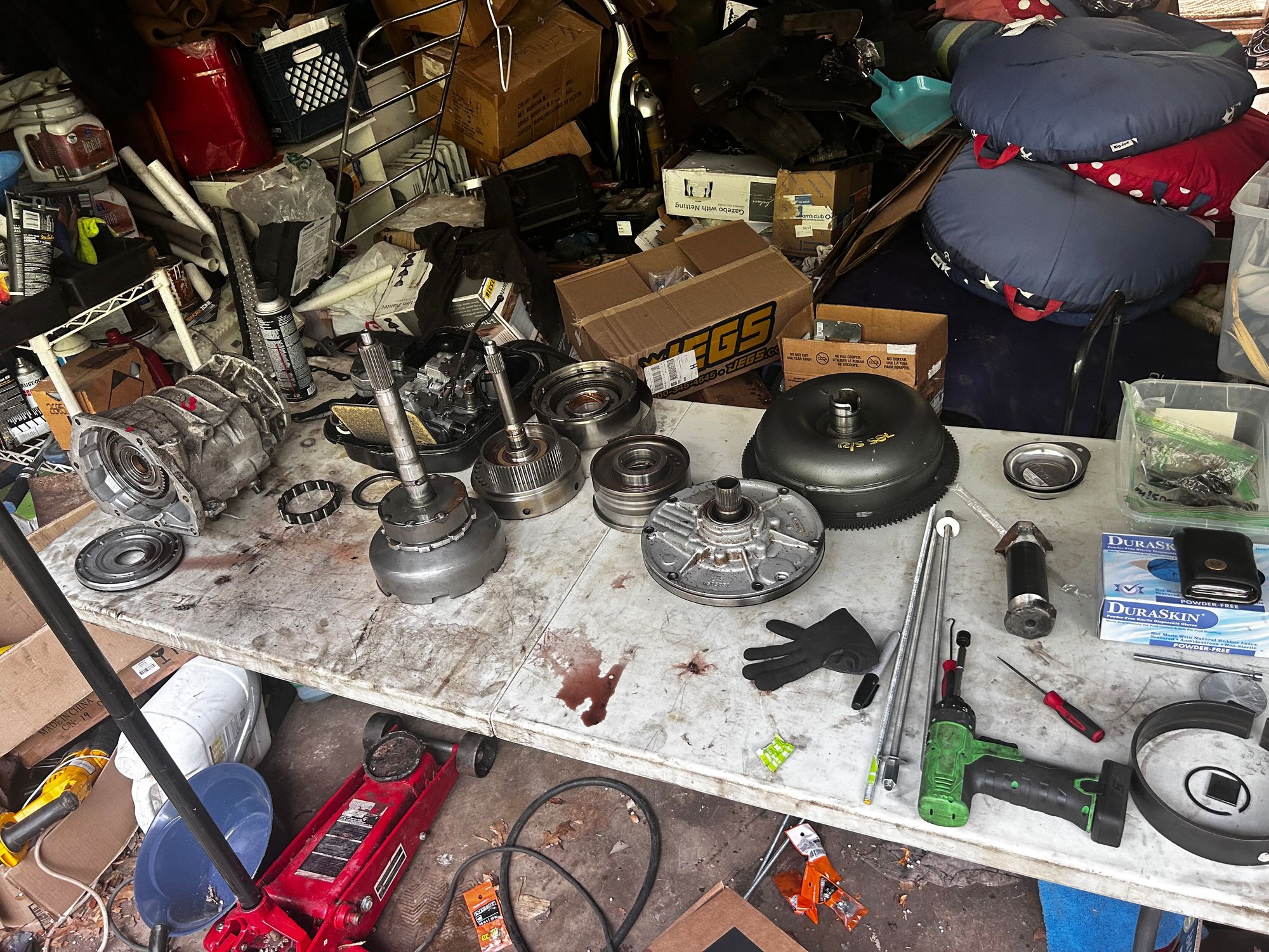

my current question, on what i believe to be 4th gear, after pulling the old clutch packs, and putting in the new ones, the snap ring no longer fits in the case. what am i doing wrong?
so far, ive checked and double checked the order, size and amount of plates and clutches in the pack. the same. ive double checked that the spring plate and other snap rings and seals are flush, properly oriented and installed in sequence.
do i need to wet the clutch plates? like ive said ive never done this before, but as far as im aware, once assembled the snap ring should go in and the clutches shouldnt be so squeezed that they cannot turn by hand. if i clamp them down with a rubber tip c clamp i can get the snap ring in but everything seems preloaded and doesnt spin. i can post pics after work but i feel SOL on this one. any advice on where to look on here or what to do is appreciated
the trans internals layed out
internals angle 2
trans pulled and stood up for TC removal
angle 2
angle 3
Some of those snap rings are tapered and they must be installed with the taper in a certain orientation AND the gap in the ring must be put, in some circumstances, must be put in a certain position for clearances as well.
