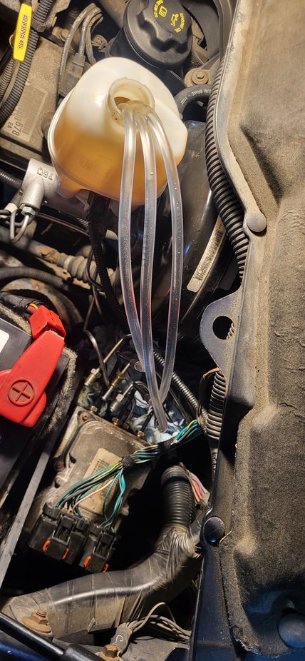

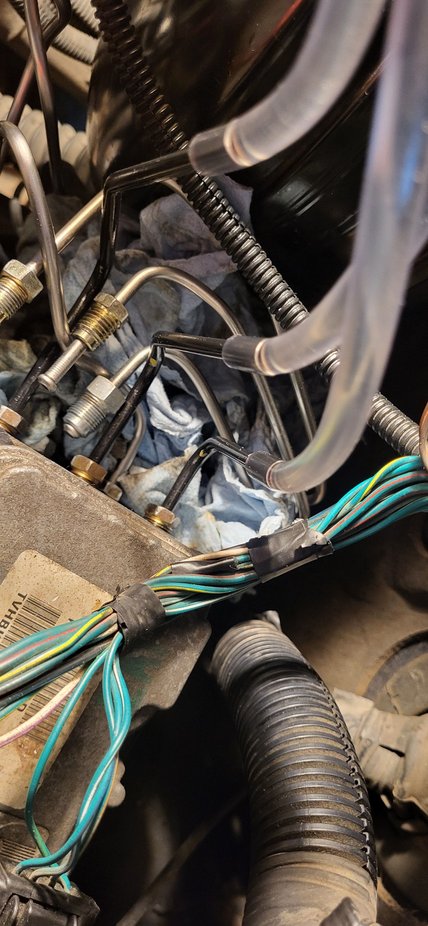

With this setup, I have been pressing the brake pedal down many, many times to purge the air. Then when tubing was clear of bubbles, I ran the ABS bleed with scanner multiple times. Then more brake pedal action. More ABS. Over and over until finally, no more air bubbles. I am also letting it sit for a while and then going to do it again.
Then, as quick as I can, hook up the trucks brake lines and run a four corners bleed. The lines and calipers are are ready free of air. So there should be really nothing to bleed out.
After this I am living with it.
And to be clear, the Local Junkyard ABS/HCU is back in the truck.
I have high hopes on this ultimate setup working.
I have done full overhauls on brake systems with ABS before. And NONE of this was necessary.
It sure is on this 2005 era Kelsey Hayes ABS.
I will report back on final results.
