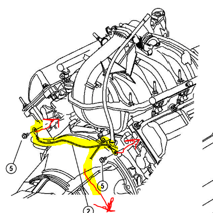

I just did a Camshaft / Lifter swap, engine was in the process of being torn down. I disconnected the Grounds from the back of each head and never thought about it again until I went to install them again. The ground strap has 3 spots for bolts to go through. See pics below. One goes on the back of the Driver side Head that jumpers to the Passenger side head, which then is grounded to the firewall on the Passenger side. Mine was broken from the Passenger head to the firewall. See pic below. The RED arrow I made which would be where the ground strap goes that portion of the strap was missing. There was a tiny bit of my old ground strap still connected against the firewall. I was unable to remove the nut from the bolt before it completely broke. Also laying under the truck you may see the ground strap hanging if its broken. It should be visible.
