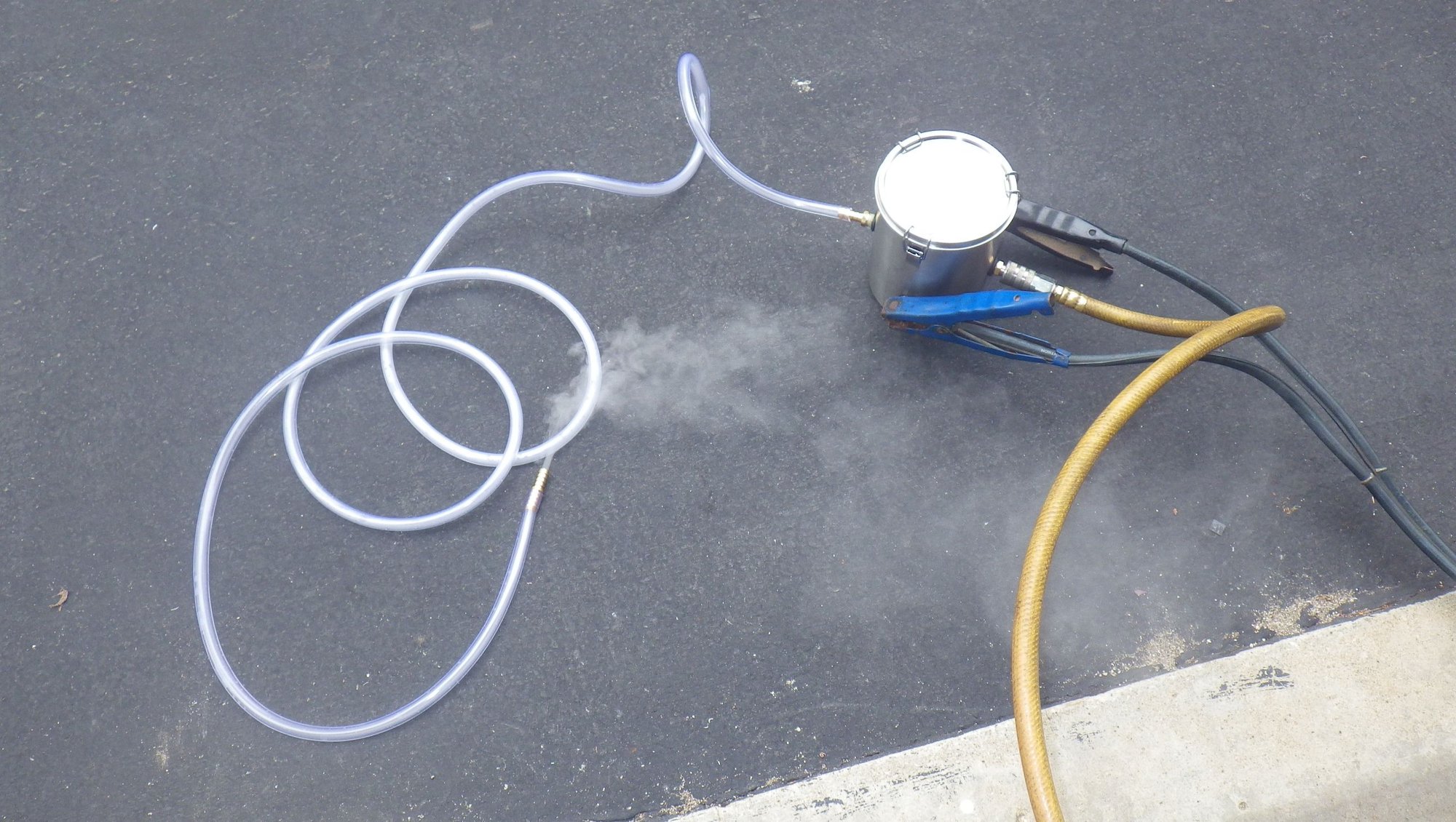

"Called a shop that could do the smoke test. Quoted me around $120, and that’s even if they can’t locate the leak..........."
For that 120 you can make your own..............

What are you smoking in that?
Old Nov 19, 2023 | 08:56 AM
Daves69's Avatar
Daves69
Joined: Dec 2012
Posts: 355
Likes: 6
From: Chi - west
Lol, mineral spirits MINERAL OIL and a tiki torch wick........
