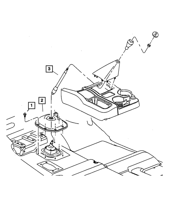

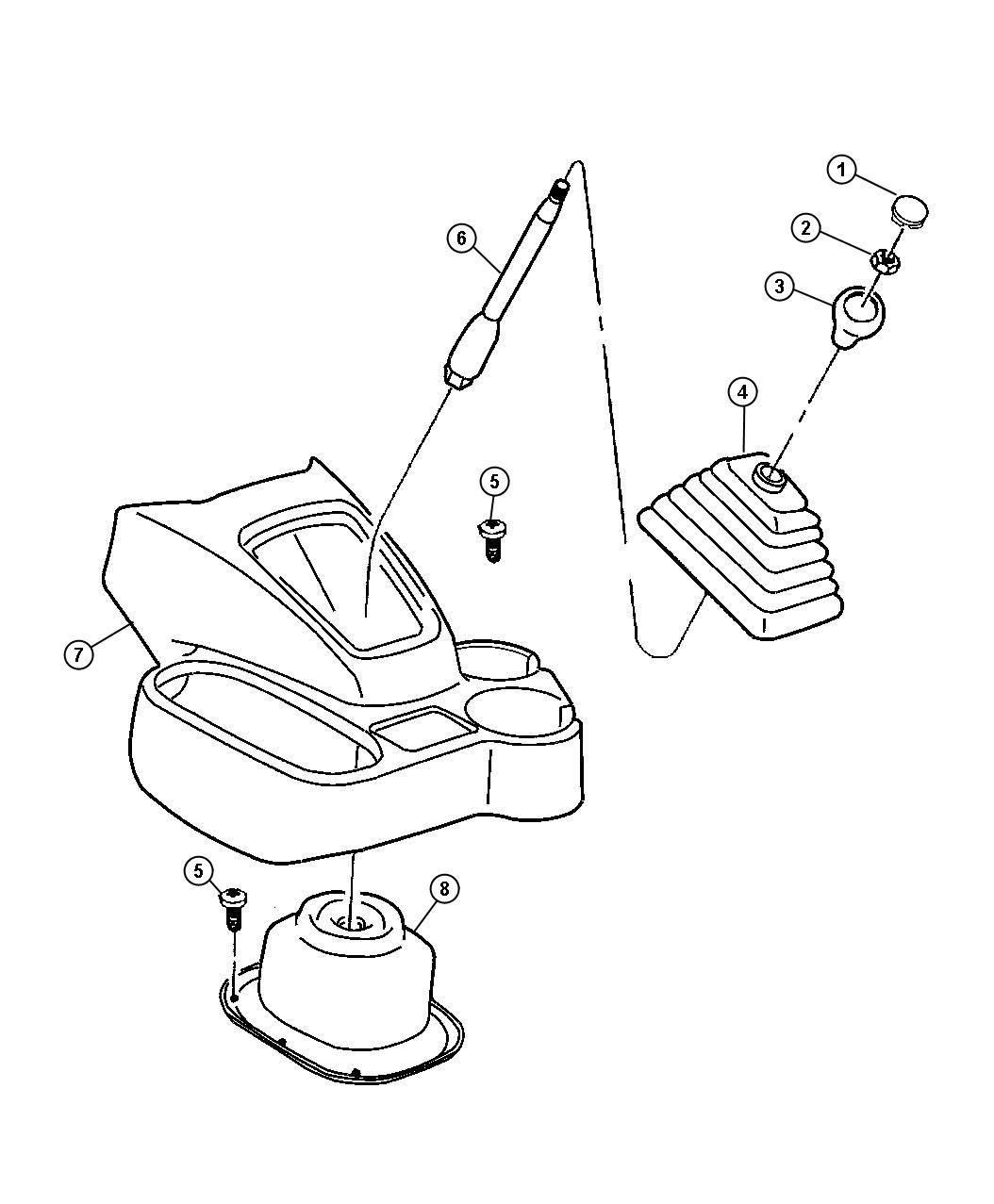

I’m converting my auto 03 ram 2500 to a manual and I’m installing the original floor console for the manual truck. Problem I’m having is I don’t have any of the screws to mount the floor console or to tighten the shifter boot down. From the diagrams I’ve found it looks like the same screws for both but does anyone know what the molar part numbers are for these screws? I’ve found pictures on mopar parts sites but they didn’t include part numbers

I think the part number is 4741144, but I can't find anyone that lists dimensions for it. Dodge shows it as discontinued as well. I would expect that any hardware store will have them on the shelf, but, gotta know what size ya need.....

yea that’s the problem, I’m at a stand still not wanting to drill holes in my floor boards until I know what size the screws are for the floor console

When I did my manual covnersion I just bought a bag of generic self tapping screws. Thats all they are, you might have to shop a little bit if you want the big wide washer head like factory screws, I had no issue with a genreic self tapper that used a 5/16 socket. They fit the the existing holes just fine.
