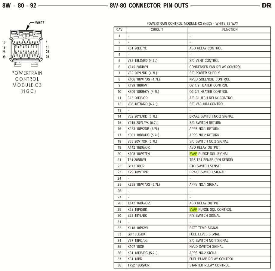

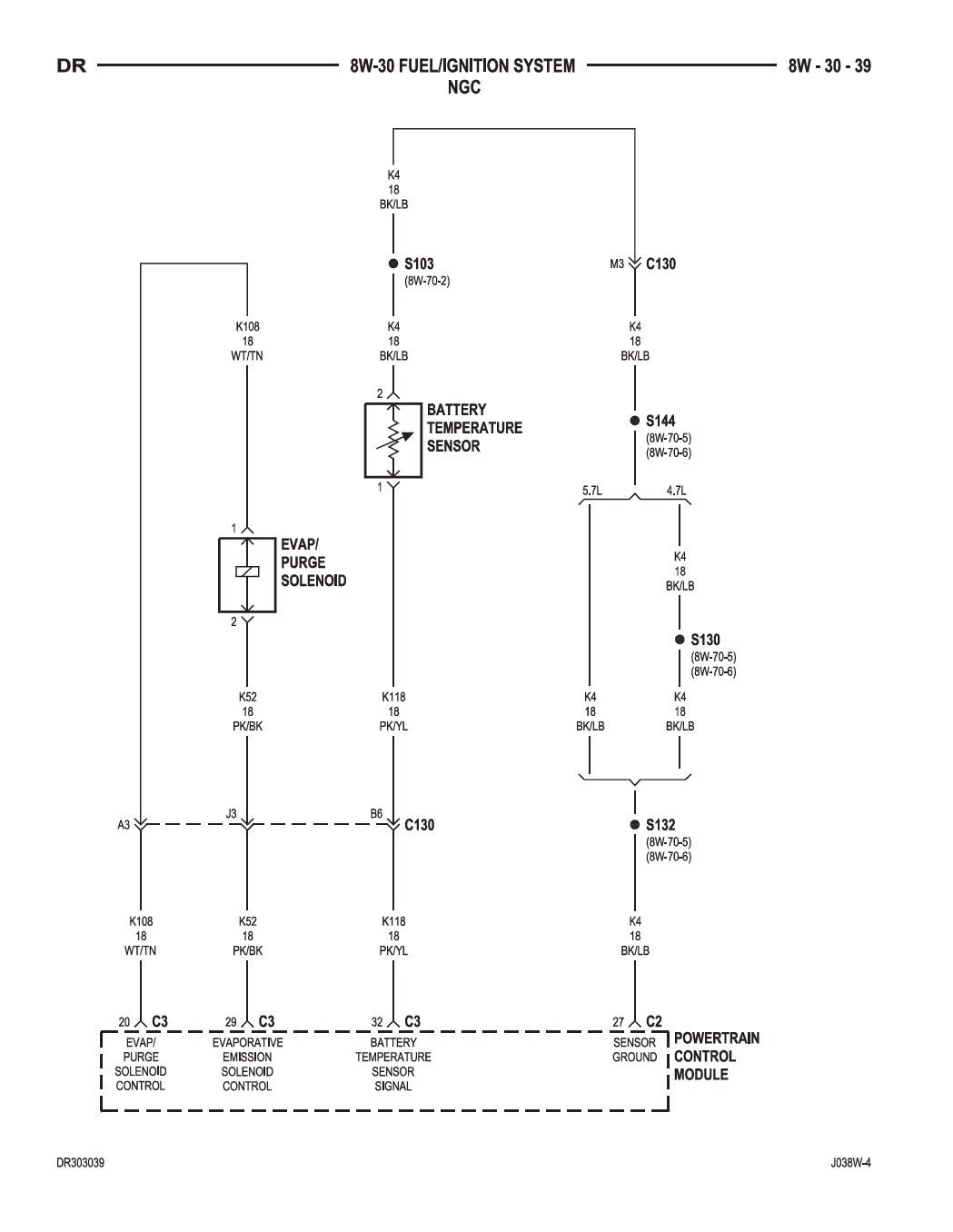

hey brother, thank you so I have the manual and I have this diagram and I’m wondering if I could just run a new wire directly from the PCM pin straight through to the purge solenoid harness since I know the white and tan one is good. It’s the pink with the black tracer, that’s giving me nothing, unless I’m not testing this properly I’m a motorcycle guy. This is my first dodge and it’s been a nightmare. I’ve done a lot and fixed lot of electrical issues on this truck but this is really killing me. Most of the issues were from the previous owner butchering the electrical system to install a remote start alarm system the owner before that took meticulous care of the truck and spent thousands of dollars with all these receipts for work and for the most part it’s in good condition so it’s driving me crazy that I’m having such a hard time physically tracing this wire

You can run a bodge wire, absolutely.
Edit - wait you said white/tan and pink/black, that's this NGC diagram. Same thing tho.
So you can run a bodge wire from pin 29 of PCM C3 (see my previous diagram for C3 location) to the sensor
Here's the PCM C3 pinout.

Great so I can just cut where I crimped / connected the wire back together and run it directly to the solenoid because that’s the only pink and black wire on that connector was the one I repaired
thank you I was concerned that that wire had to bounce off or through other components in the system so if I just ran that wire direct to the purge solenoid would’ve caused more problems truly thank you this makes my life exponentially easier
Old Jul 25, 2024 | 07:32 PM
Prismatic's Avatar
Prismatic
Joined: Dec 2012
Posts: 895
Likes: 56
Yeah it just runs through C130 but that's it
