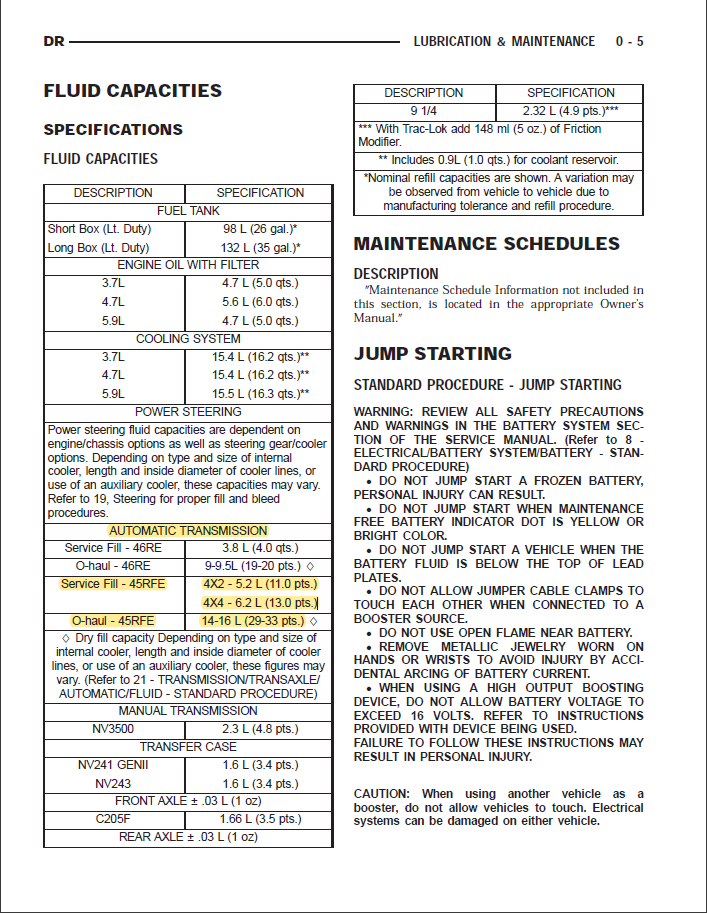

trans was fully rebuilt, like fresh off the assembly line, ALL internals are new, new valve body, full rebuild kit, torque converter, solenoid pack, i can’t find a clear defined answer to how much fluid total i will need, any links or straight up answer will help, thank you

What I am seeing is 10.5 to 11 quarts. If the trans and torque converter are completely dry, get 12, put in 9, run the trans thru the gears, (it doesn't actually have to move though, just be sure the gears engage) check the fluid, and top off as necessary.

LMAO.....then evidently you didn't look hard enough.
