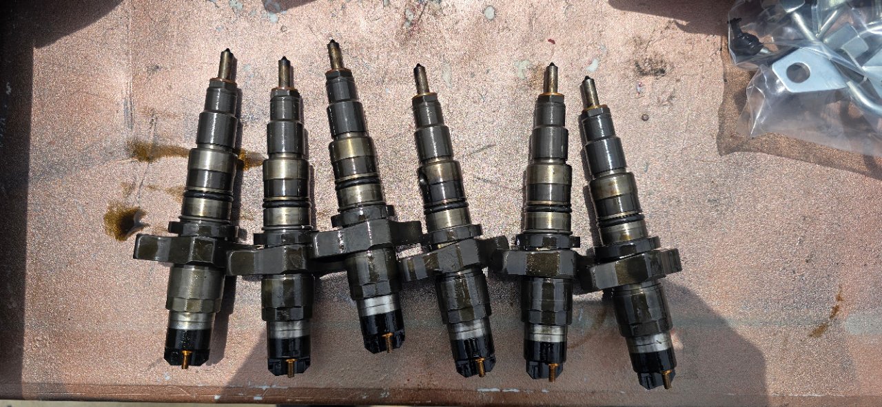

Put a new set of Bosch stock injectors in, tubes, and fuel lines. Not a bad job, took a few hours. Runs so good now. That might be the injectors being fresh, or the lack of weight from having spent all my money. But who knows.

tips look clean... 2 suggestions,
1st - consider running 8oz of Dex3/Mercon ATF with 24 oz of TW3C 2 stroke oil in the fuel from time to time (I do every other tank).
2nd - Consider running hot shots stiction eliminator in the oil every oil change.
