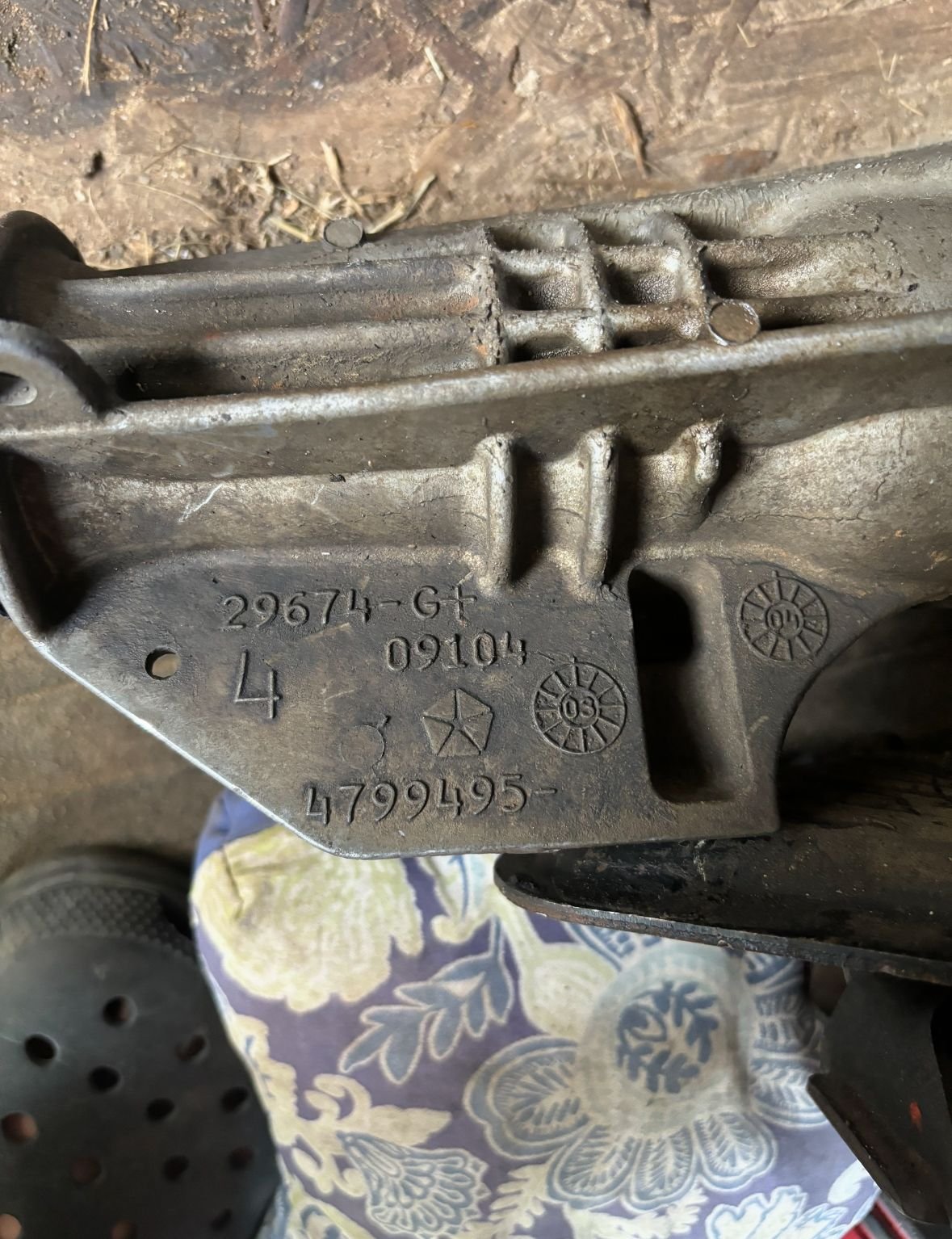

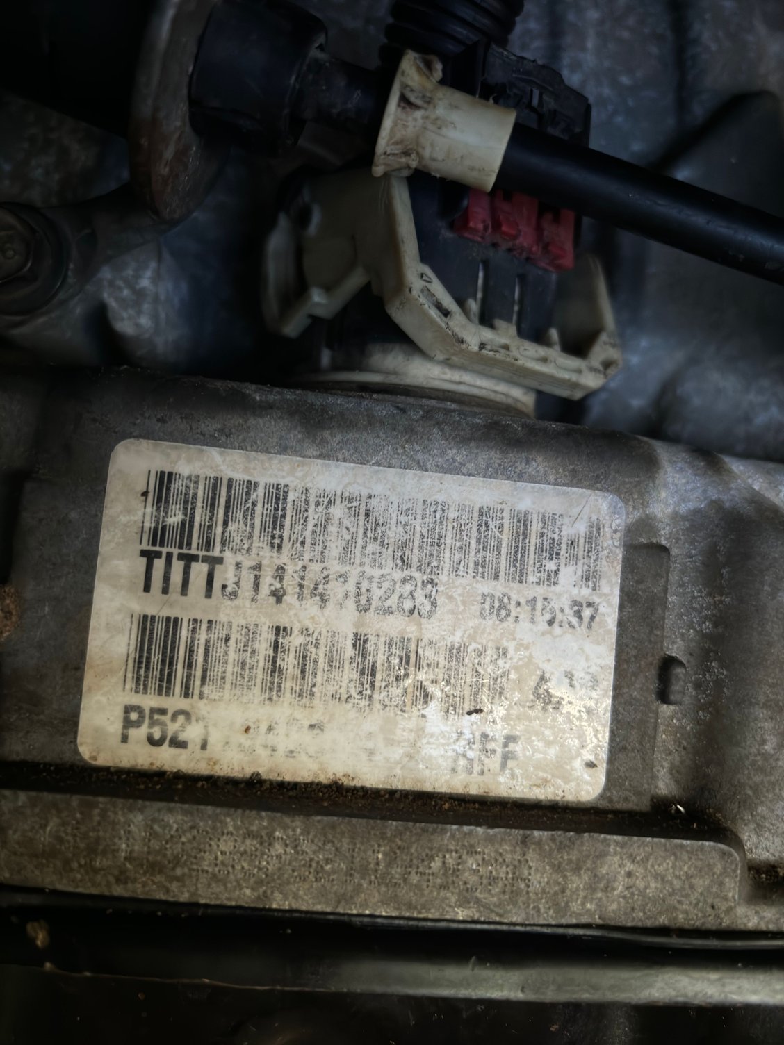

can someone please ID this trans, dealer says it comes with a 4 speed from the factory but i can’t guarantee it wasn’t swapped, i also have a pic of the converter sticker too if needed

45rfe

Only difference between the two is the control module..... Physically, they are the same. I used the part number off the extension housing to find it.... If you could post the part number on the trans, bottom number on the white label (I can't read it from the pic.....) I could likely get more specific. 2000-04 is what I get for year range.

i pressure washed the case and the ink on the sicker went with it so that’s the best i have, i can try to decipher it and post it when im home
