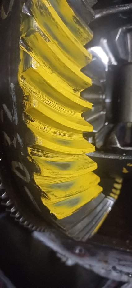

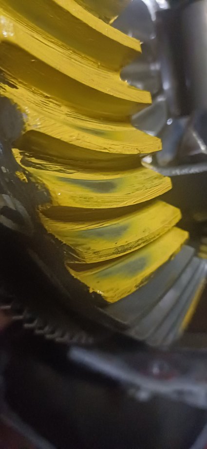

Just an update, changed the bearings and went back with the old shims. Went ahead and set pinion bearing preload to 20 in/lbs. I screwed it up and overtightened it the first time, luckily I bought two extra crush washers lol. Changed the limited slip clutches and that was a total bear to do, wouldn't wish that on my worst enemy. Got brass flakes all in the carrier with my brass punch, spent a while cleaning them out, ran out of break cleaner and I'm not sure if I got every last bit lol. Took a while to set the backlash but got it to 6 thousanths with everything torqued down, did a pattern test and I feel like it's good enough.

Setting backlash was kind of a pain, not many youtube tutorials go into detail about it and those that do weren't 100% right for me, but were enough for me to figure it out. Take your time and get it right, it's 100% worth getting it right. I found a tool on amazon for like 20 bucks to turn the adjusters down the axle tubes. I also used a cheap dial gauge off of amazon, it was a pain to get set up in the right position, and I couldn't zero it out because the bezel was so tight it would move the gauge itself around, but it worked. I'd recommend getting a nicer one, but that cheap one did the job, maybe the harbor freight ones would be better lol.
