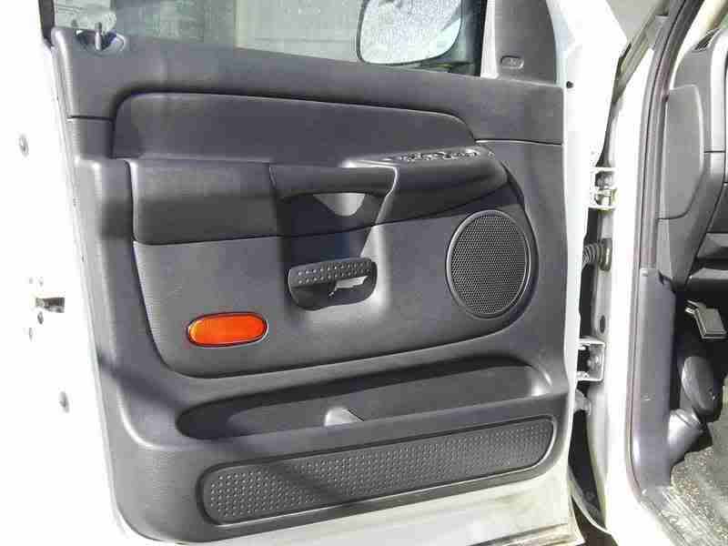

Old Mar 8, 2007 | 05:16 PM
squatchie16's Avatar
squatchie16
Joined: Jan 2007
Posts: 141
Default RE: Speakers / Amp. upgrade
8" Midbass
Sound Deadening (rear door, front looks better)
Front door when done
