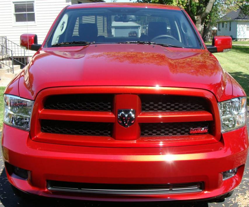

As for my Hemi badge mod.... I used two bolts that I cut the head off of, some high strength epoxy to attach the bolts to the badge, two fender washers and two nuts. I would have tack welded the bolts on but hard to weld a metal bolt to plastic
