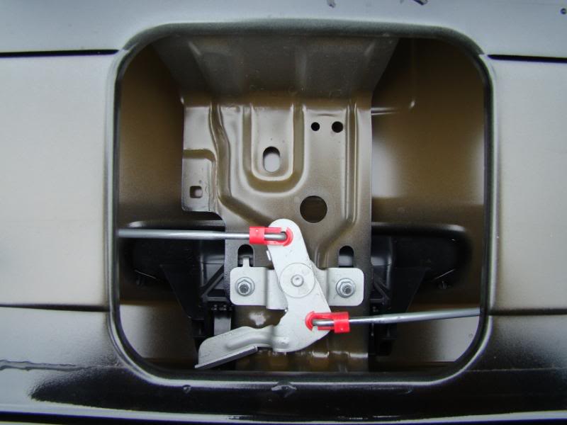

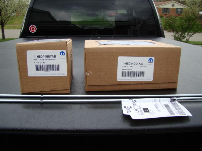

If you have the key locking handle and control assembly all you need is part no. 82211668-AB.
Has to have that black plastic lever coming from the control assembly you see in the pictures. The lock cylinder moves that rod where you see the little rod going through it.
The solonoid attaches to that lever and moves the lever when you hit the remote...see the two rivets, they are holding a small bracket the solonoid is made to attach to.
That black plastic lever engages the assembly....lever disengaged..pull the handlle and the assembly does not turn and move the rods. Lever engaged the pulling the handle rotates the control and moves the rods...opens the gate

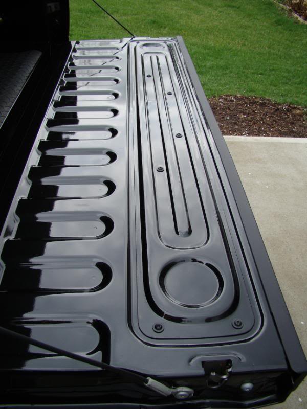

Take off you dads tailgate access panel. Remove all those Torx screws and lift it right off. A couple of minutes.

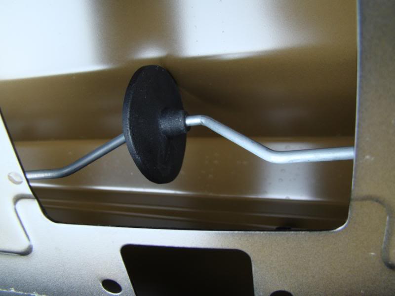

The rods for the stock non locking gate have a "V" shape in them where the rubber isloators go
The rods for the locking gate are straight with little crimps in the rod to hold those rubber isolators in place to keep the rods from banging around inside...as smoothbassman explained.
The parts guy at my dealership said I could buy the whole package.
Locking handle, new control assembly, new rods and the solonoid kit.
I thought I would have a PE soloniod as I said so I just ordered the locking handle and control assembly and the rods. When I went to get the handle and stuff my plans had been changed...bought the remote locking kit from Mopar since they had it in stock.
The part numbers I list are what I got! Who knows, Dodge might have chaged the numbers. Easy enough to make a mistake typing this.

Tailgate panel.
Tailgate panel open.

One of the rubber bumpers.

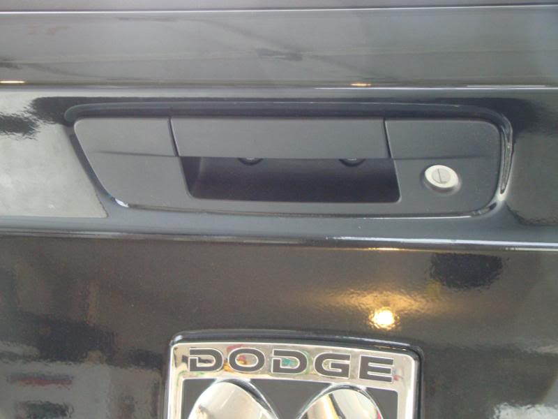

Here it is after I was all done. About 15 minutes total.
