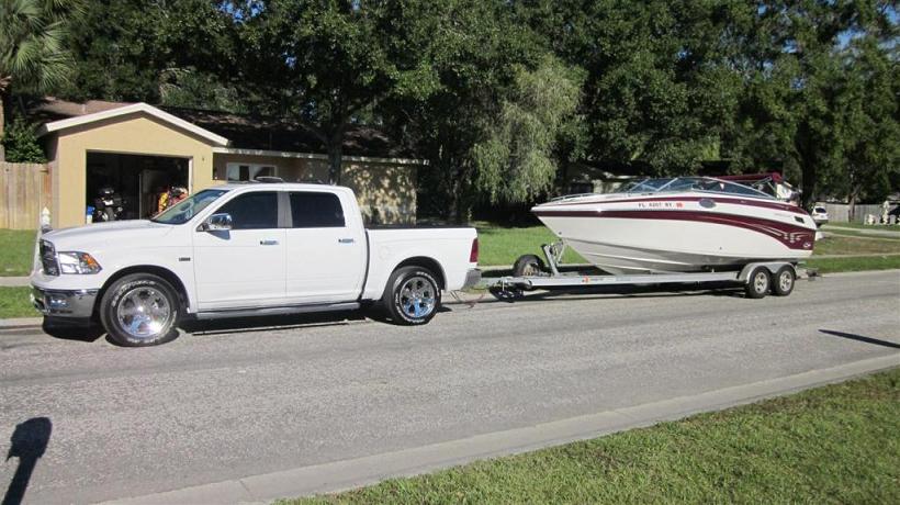

I really didn't like the big chrome RAM 1500 letters on the doors or the Laramie tag on the tailgate so I finally got them taken off. Took alot of WD-40 to get all the residue off but heating them up first seemed to help.
Followed it up with a good coat of wax and it looks great. Debating on removing the "Hemi" tag as well. What do you think?

Looks good man. Getting ready to remove the RAM 1500 off of mine as well. I kind of like the Hemi tags myself but it's up to you what you want to do. I'll be shaving the SLT and 4x4 logos off mine as well.
Goo Gone seems to work pretty well for getting rid of the residue.

I tried goo gone and it didn't work for ****. After removing 14 letters I can tell you this is what worked for me.
-Fishing line to get behind the letters and saw through the tape.
-Hair dryer to heat up the sticky tape and peel it off with your finger nails.
-WD-40 on the residue. Let it sit and then scrub with some elbow greese. (Repeat several times)!!
It took me a couple of hours to get them all off and then wax the doors but it turned out great.
Goo Gone should be renamed to goo stay.
