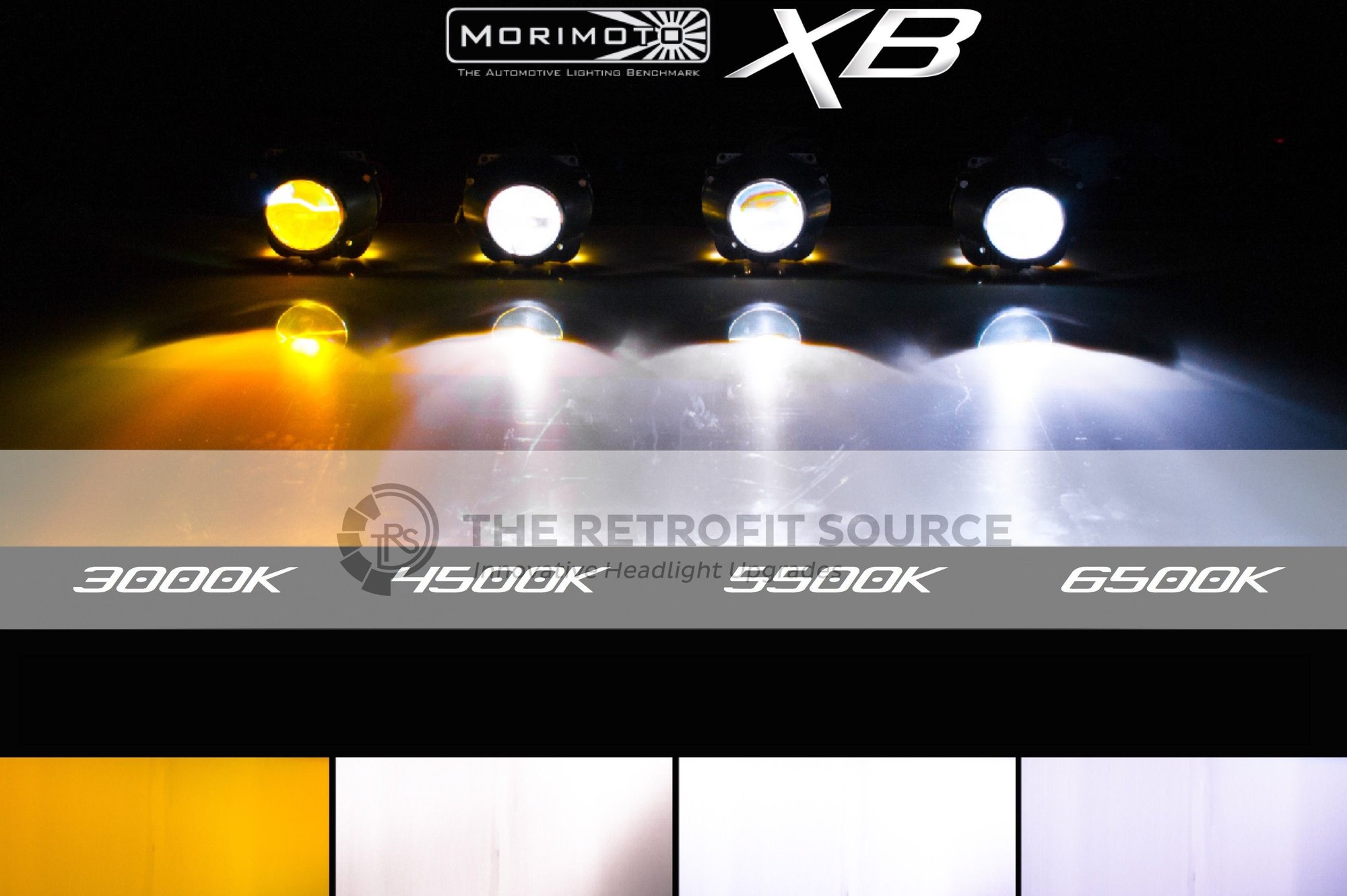

6000k will generally give a slight hint of blue. I always like to use RetrofitSource's reference image.
