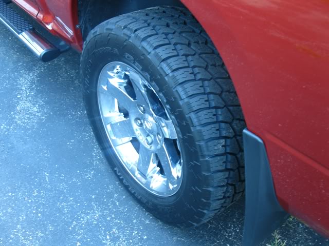

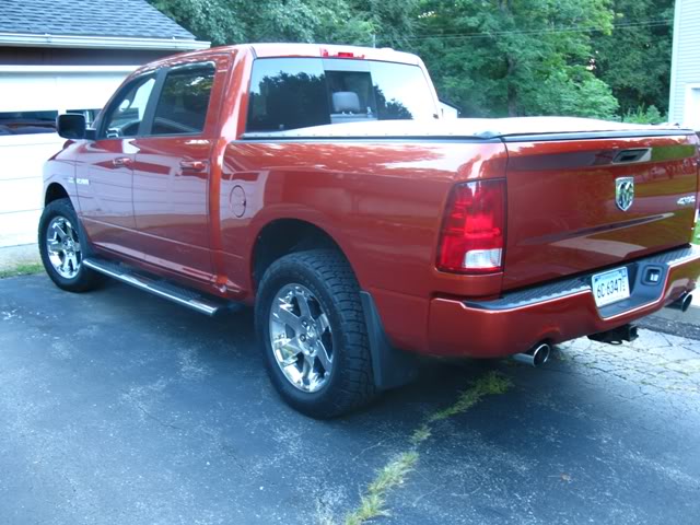

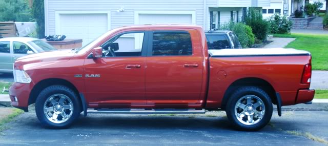

Got 305-55/20(33x12.5) Terra Grapplers on stock wheels. Stock height, no leveling/lift. The only rub I get on the street is at full right lock going forward. Full right lock in reverse doesn't hit nor does any left turn.
Haven't had the truck on the trail yet. Wheel is turned a bit in the last pic which is why it looks offcenter in the pic.
I have not noticed the "knobby" feeling at take off. They aren't that aggressive.
