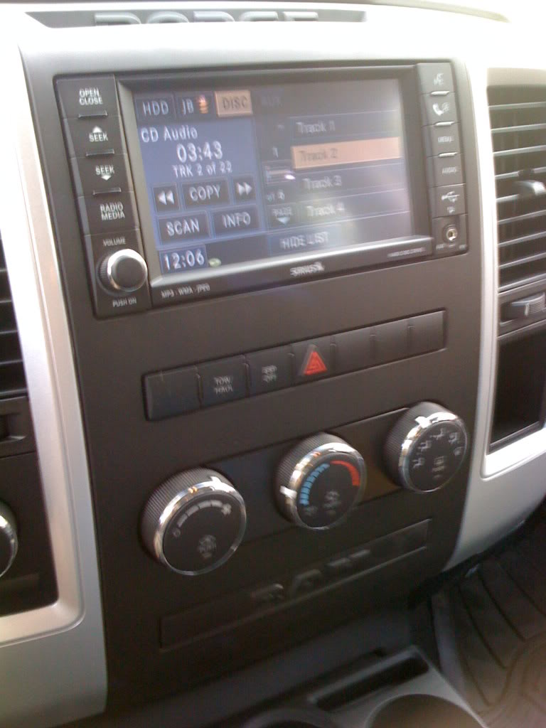

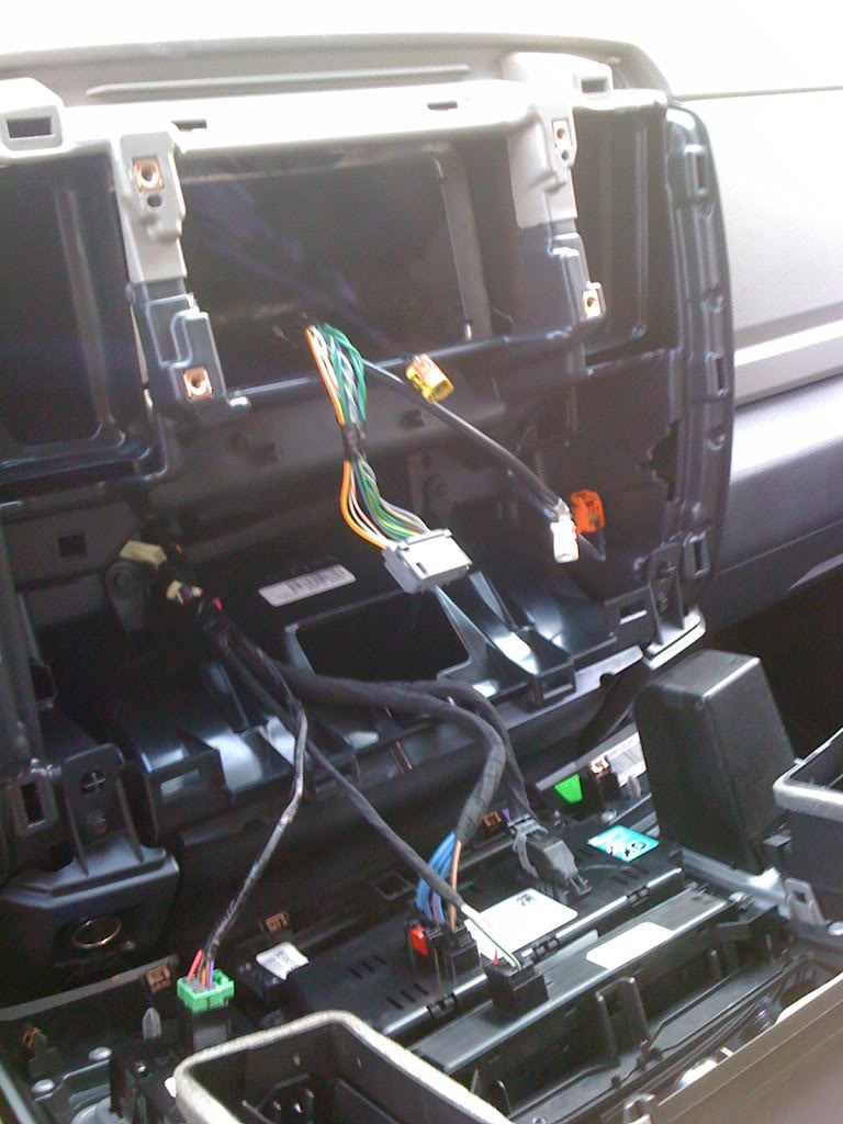

Just a few pics. If you don't have the center super duper console that is in all the other instructions here is how to do it on yours! Just remove the rubber piece off of the dash (above the deck). Then remove the two star screws (can be done with an allen wrench). The the whole thing pops off as one big piece. Pics below and you can pop the sucker out by hand. Just start in a corner and work your way around. Enjoy! I know I'm enjoying my $200 myGiG !!!!
I also noticed during my install that we all have the wiring for the "wall socket" It's pictured in the last photo. The orange plug is just sitting in a "holster" unless you have the socket installed. Just FYI
