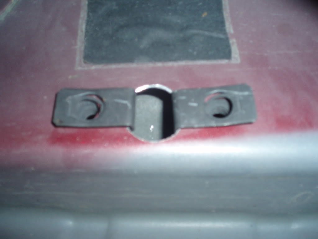

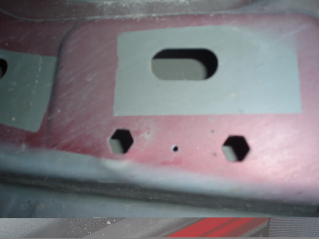

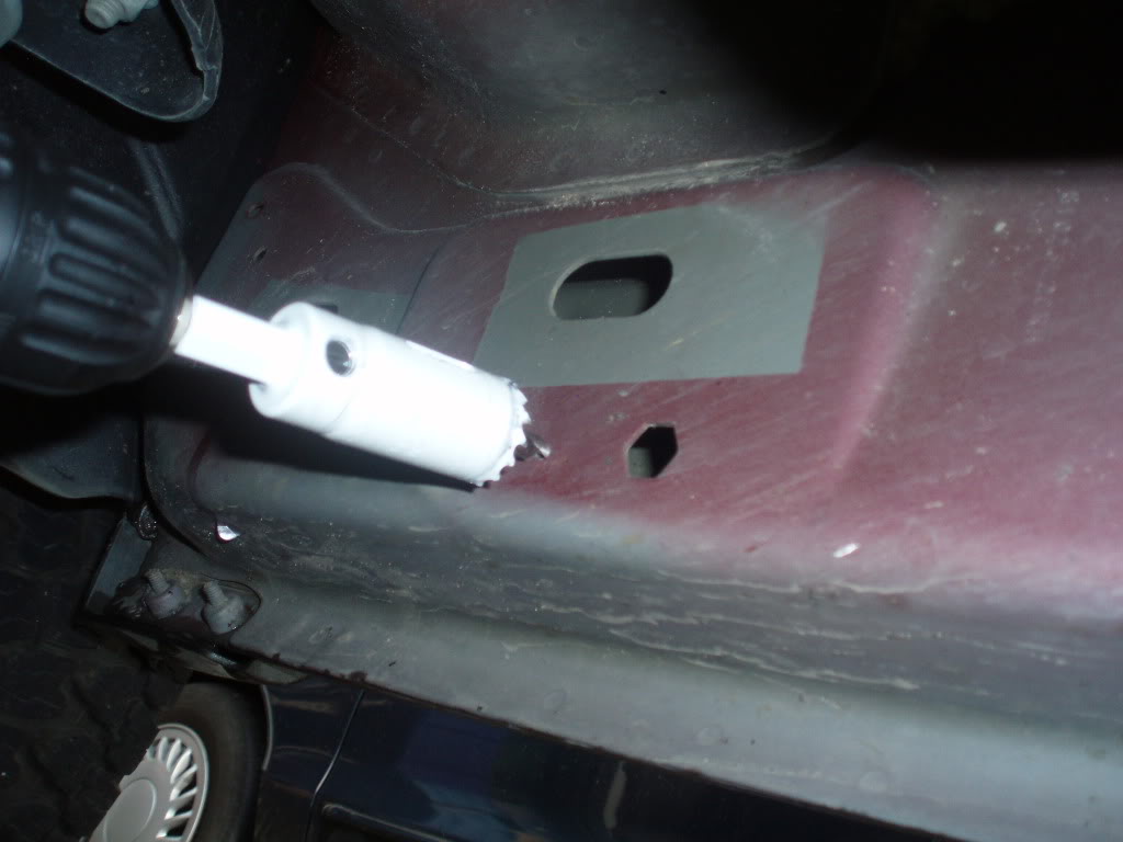

Old Jun 23, 2009 | 11:13 PM
sarguy01's Avatar
sarguy01
Joined: Feb 2009
Posts: 1,661
From: Virginia Beach
The first hole drilled.

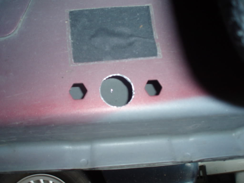

I am nuts for doing this!
The big hole!

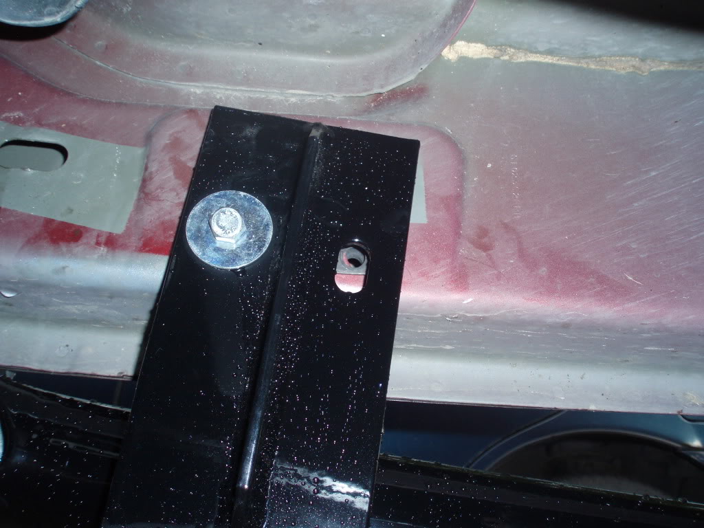

With the clips installed.

Old Jun 23, 2009 | 11:18 PM
Ironsides's Avatar
Ironsides
Posts: 153
From: New City, NY
Dumb question: Could you have used the rivnuts that come with the Mopar side steps, to avoid cutting the holes?
The rivnuts go in the same hex holes that the mounting hardware ends up in for the bars you got, so I imagine if the thread is the same, rivnuts would be an option.
