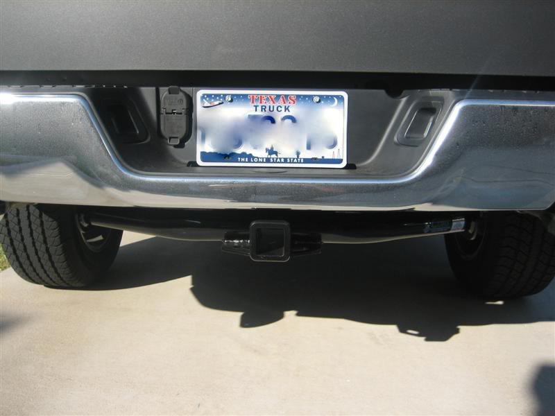

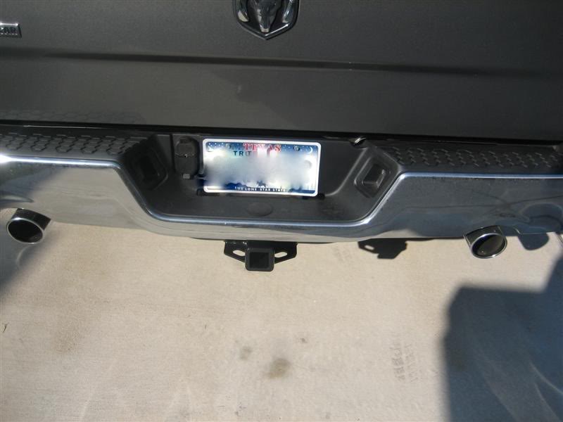

Default pics of 13374
Here's a rear view from 2 angles, plus a shot from underneath so you can see how far back the crossbar sits.

thanks Greenblur. Thats exactly what i wanted to see. i be ordering my hitch in the morning!
