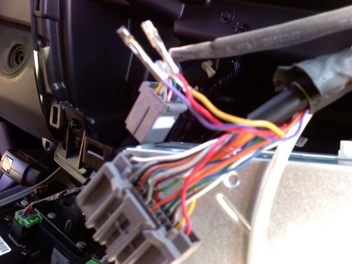

I need the radio color code/pin out diagram for the C2 (grey) connector on the back of the radio on our new Rams
The dealer installed the factory camera yesterday and installed the Camera wires in the wrong connector but later realized that the were supposed to go into the White C3 connector.
They left three wires out of the C2 Connector by accident. I noticed this while I was installing my All-Gig today. It is staying apart in the driveway until I get the wires back in. I know they are supposed to be plugged in because I read the instructions myself today and the grey connector is supposed to be left alone...
idiots.... I am wondering if this is effecting my ipod not working??
anyway, slots 3, 4 and 5 are empty and I have three wires available to go in them. A purple, yellow and red wire.
PLEASE HELP ASAP!!

Thanks but no go on that info.
That plug that is in my pic is actually the IPod harness. what you guys gave me is the female end on the radio.
I need to know where those wires go back into the plug. the C2 Connector where the ipod goes into leaves 3, 4 and 5 blank from the factory. But when you put the Ipod cable in there are wires on the harness that goe into those slots..
anyone have a harness around that can look at it or possibly tell me which color wires go into those slots...
TIA

I have to go to the dealer tomorrow for a service appointment....
BOY am I gonna complain. I called an internet store who had the adapter and told me where the wires go...
IPOD is working now. I am so mad.. The installer left those wire EXPOSED.
