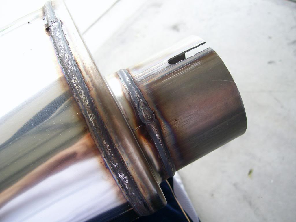

Quality: The muffler is a magnaflow muffler retrofitted for the Ram. It already has extension pipes welded on, so there is no cutting or welding required. The welds are decent, not the best I've seen but still pretty good. The mufflex has a polished finish, which gives it a little bit of bling but it doesn't matter because no one will ever see it.
The Magnaflow muffler is a straight-through perforated design. It is very free flowing, much better than the stock muffler.

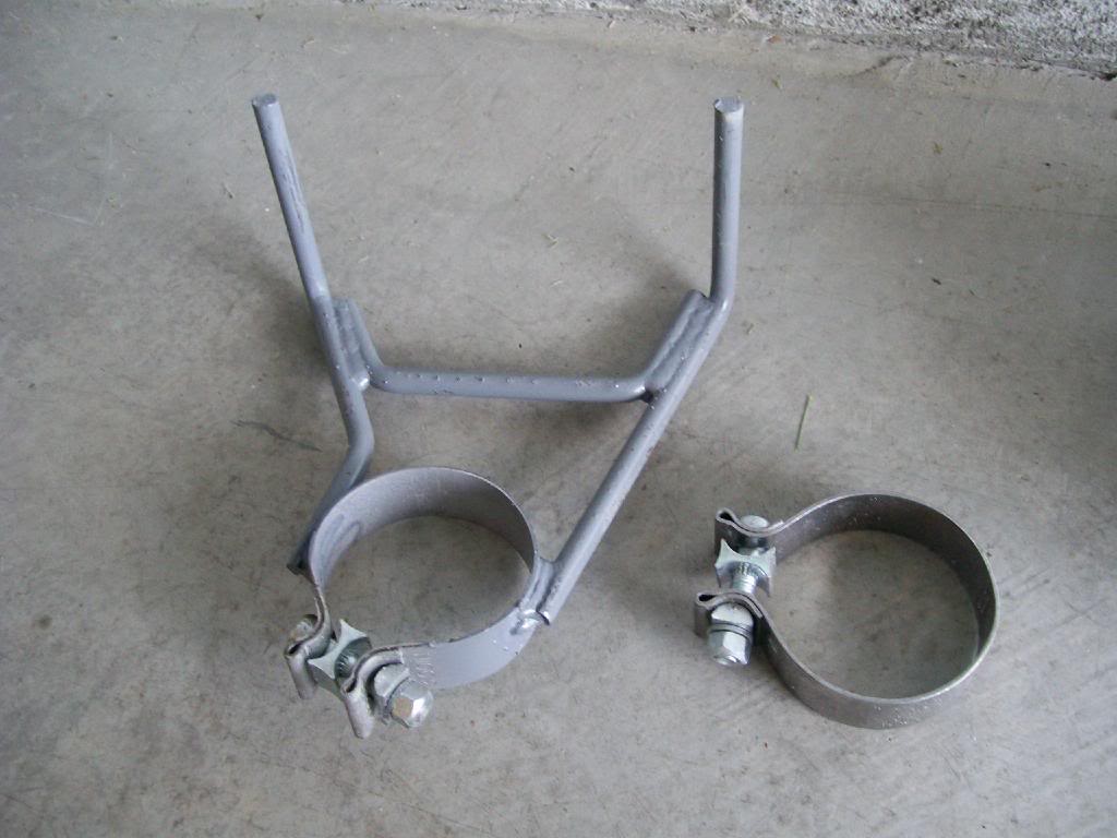

Installation: It was pretty straight-forward. The hardest part was removing the stock exhaust. The nuts on the stock hangers are on there pretty tight, but it's manageable. First step is to loosen the stock hangers on each side of the muffler.

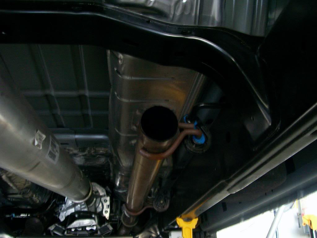

After loosening the stock hangers you can remove the rear section. It helps to twist back and forth to help generate power to slowly slide the rear section out. The fit is pretty snug, but twisting back in forth will allow you to remove it a little bit at a time. Once the rear section is removed use the same twisting motion to remove the stock muffler. Be careful once the stock muffler is removed because it is heavy and you don't want it to fall on you. Here's what everything looks like after moving the stock muffler.

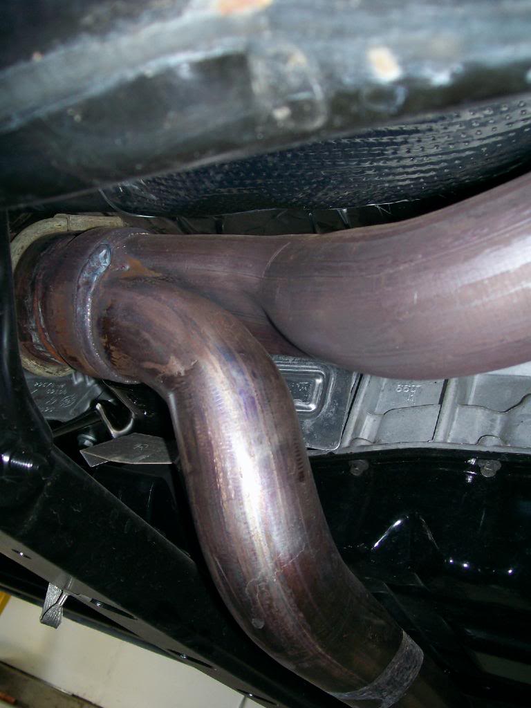

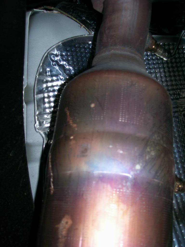

After removing everything I also took a few pictures of some of the stock components, for those who are interested. Here's some pictures of the stock catalytic converters and the incredibly restrictive y-pipe. I had no idea the y-pipe was this restrictive. I might change that in the future.

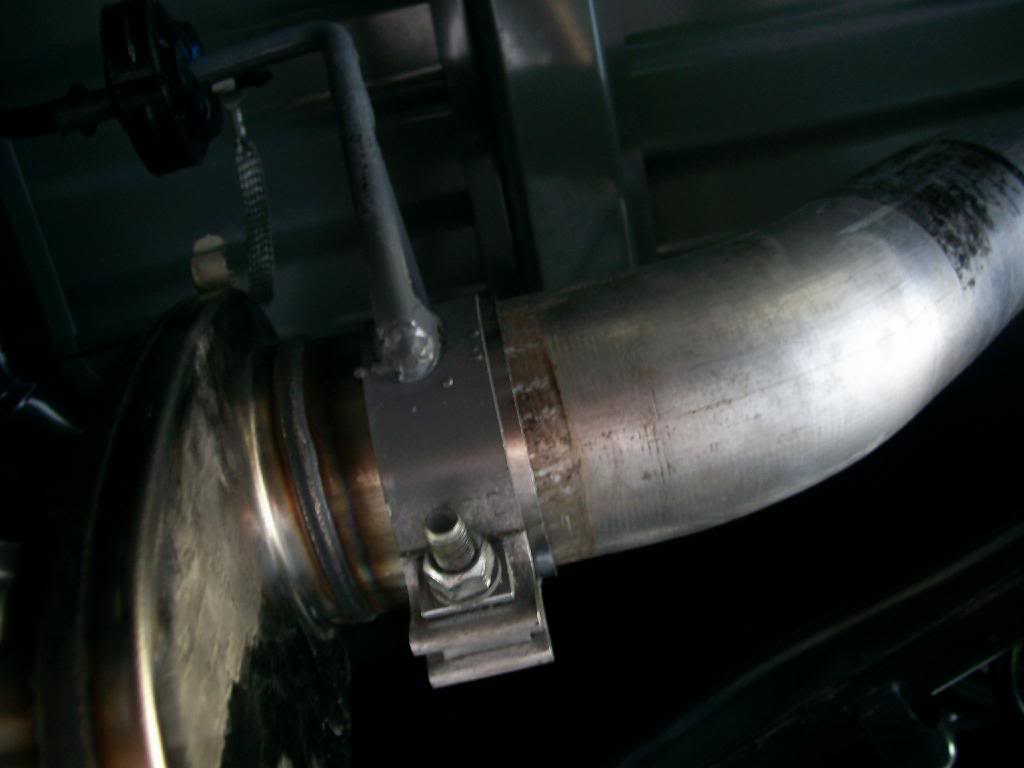

Now install the Mufflex muffer. The fit isn't perfect (as other's have noted). The front end fit good and there were no issues. You can tell it doesn't match perfect to where the stock muffler lined up, but there is no leak, so I don't care.
The rear side of the muffler is a different story. The fit was very poor and I can not manage to get the rear section to fit properly. There is a small leak as a result. I tried for a long time but couldn't manage to fix the leak. I tried to relocate the clamp to different spots, but it did not fix the leak. I also tried driving it for a week and working on the leak issue again, but still no luck. I will eventually take it to an exhaust shop and have them give it a try, and if they can't fix it I'll have them weld it.
