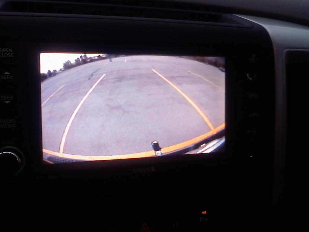

I know that I'm hijacking this thread, and am sorry for it, but I would really like to see Dustinmc5's e-bay cameras field of view. Do you see what the OE camera sees? Could you post a picture of your display? Thanks.

Here's a quick pic I took with my phone.

Excellent! Thank you. I think I'll go that route as well.
