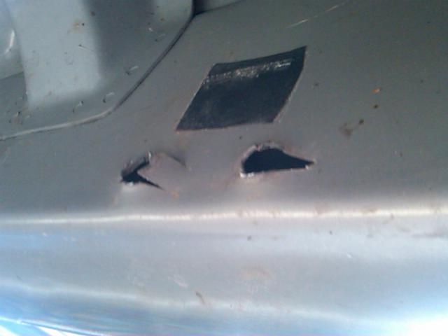

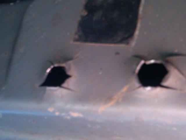

hi all i just had my passenger side nerf bar pull threw the sheetmetal and come off the truck when i stepped on it anyone else ever have this happen

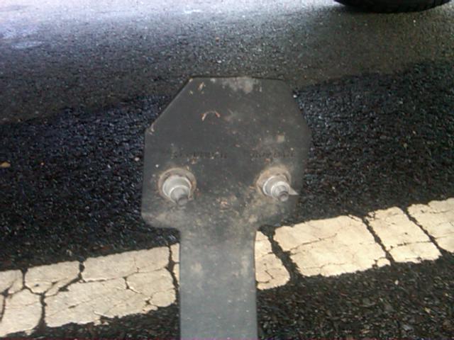

here are some pics
Attached Thumbnails deezee 5" nerf bars-1.jpg   deezee 5" nerf bars-3.jpg   deezee 5" nerf bars-4.jpg

Looks to me like the washers are missing or were way to small......

there are no washers used the bolt kit supplied with the bars

That would suck. I think I would be contacting DeeZee and sending them pics, and find out what THEY are going to do to fix this problem. Sounds like a very POOR engineering design.
