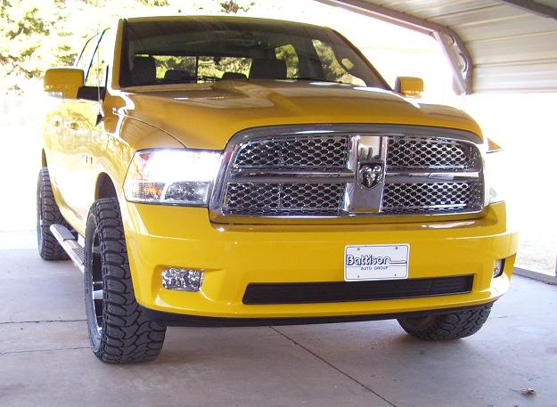

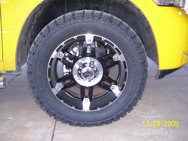

since your changing your rims from 17's to 20's it's going to depend on the rim you get... your right about the size being the same height but your new tires are about 1.18" wider than the 17's... as long as your rims have enough offset/backspace to clear the upper A arm you should be fine.. i put 305/55R20 on mine. i don't remember the offset/backspace my new rims have but it only rubbed a little once in a while when i backed up at full turn. anyway.. it's going to depend on your rim.
Size:  61.1 KBName:  100_0804.jpg

Originally Posted by stvsherrod
that looks awesome, do you have any sort of lift on that or just rims/tire combo?

there is no lift on it in those pictures.. i have installed the bilstein adjustable struts and rear spacers.. i added the full lift the struts allowed and installed 1.5" spacers in the rear.

stvsherrod, truck looks great. Is there any way you can find out the offset and any other dimensions i may need. I want those size wheels and tires. Thanks.

Stvsherrod - What kind of backspacing do you have on those wheels? You also said absolutely no lift right?
