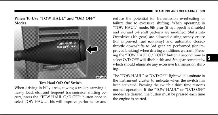

Originally Posted by Sobomaster
So I have 2 towing related questions that I can't seem to find answers to. Wondering if anyone could help me out?
1. When in the Mileage tune or 87 tune, I know you're not supposed to tow, but what exactly happens when you push the tow/haul button? I had a load of 20 bags of mulch and pushed the tow button and it felt like it was the stock tow tune.... Is this the case?
2. When in the tow tune, do I need to push the tow/haul button? Either way, what does pushing the button do? Revert to stock or is it also specially tuned in the tow tune?
When you push the Tow Haul button, it reverts back to a DCX created schedule for towing. If you're towing and meet the towing scenario in the service manual, I would use it.
The tuning doesn't change. Just the shift schedule.

Keep in mind, the tow/haul switch in the 09-10 Ram 1500 is a button under the radio, I think the pic that Sils posted is for a different year. I don't want anybody thinking they don't have the tow/haul option in their Ram if its not on their gear shifter, like I thought a couple months ago, lol lol.

Thanks for the answer Sil. So it only affects the shift schedule.
