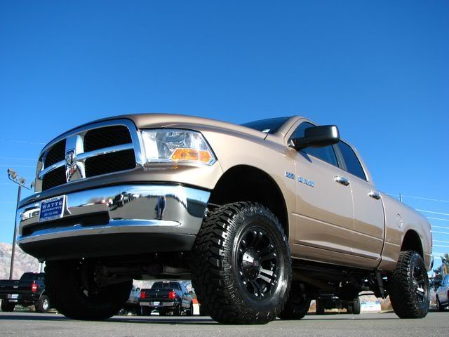

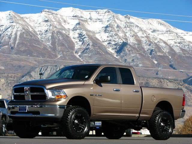

i would love my truck to look something like this....

You are viewing a bolt on suspension leveling kit and the picture you are viewing is a 6" suspension kit sitting on what looks like to be 35x12.50x(18 or 20) XD monsters (hard to tell with the angle shots)
To get a nice offroad look you would want a 33x12.50x(17 or 18) on an (17 or 18)x9 although you can probably fit a 35x12.50 just fine... NO more than a 4.5" backspacing with 0 or less offset

i am looking at the 2.5 inch rough country kit, i just want a higher ride and more offroad look.....i dont need the 6 inch lift like the picture sorry if that confused you...

Buy that truck looks like its on a lot and really nice truck.

it is for sale in Utah www.wattsautomotive.com check out there site they have tons of amazing trucks for sale
