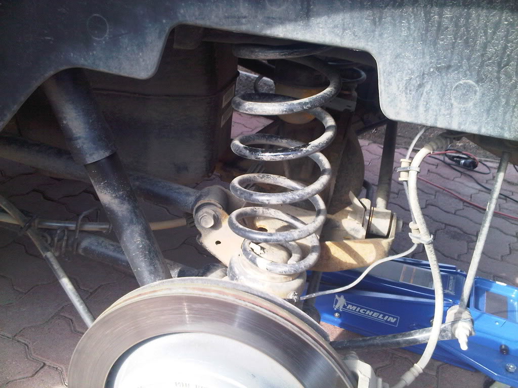

Jacked the truck up, put it on jackstands, yanked the tires, and let the rear end hang low....

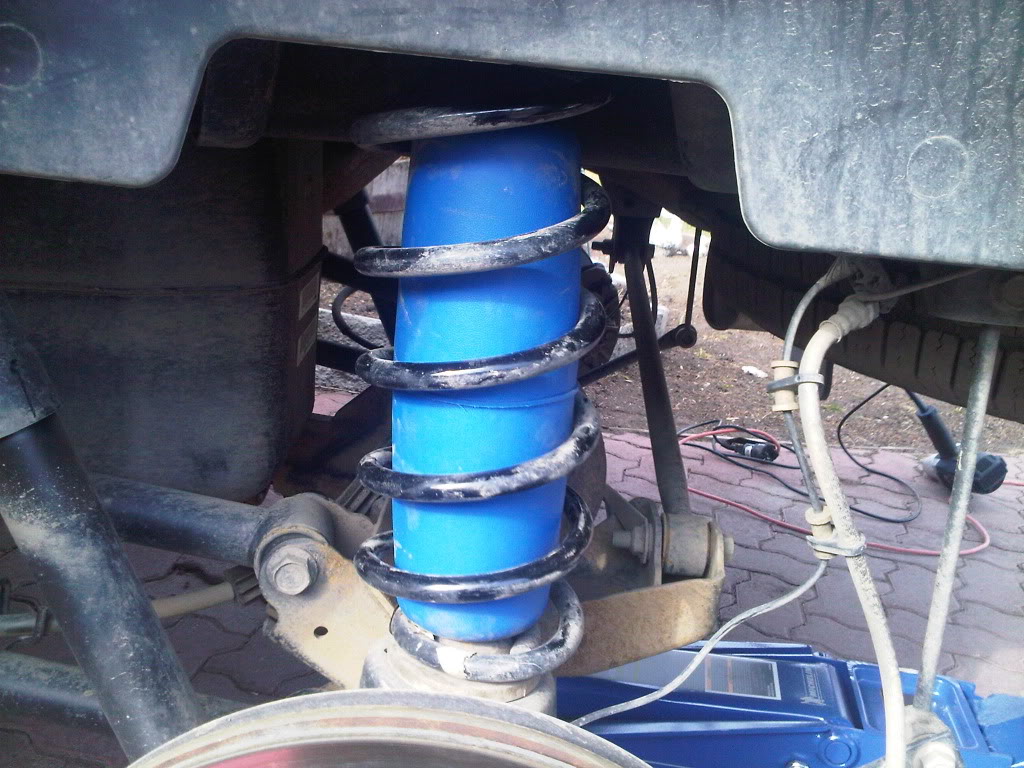

Undid the line and let them return to normal shape....

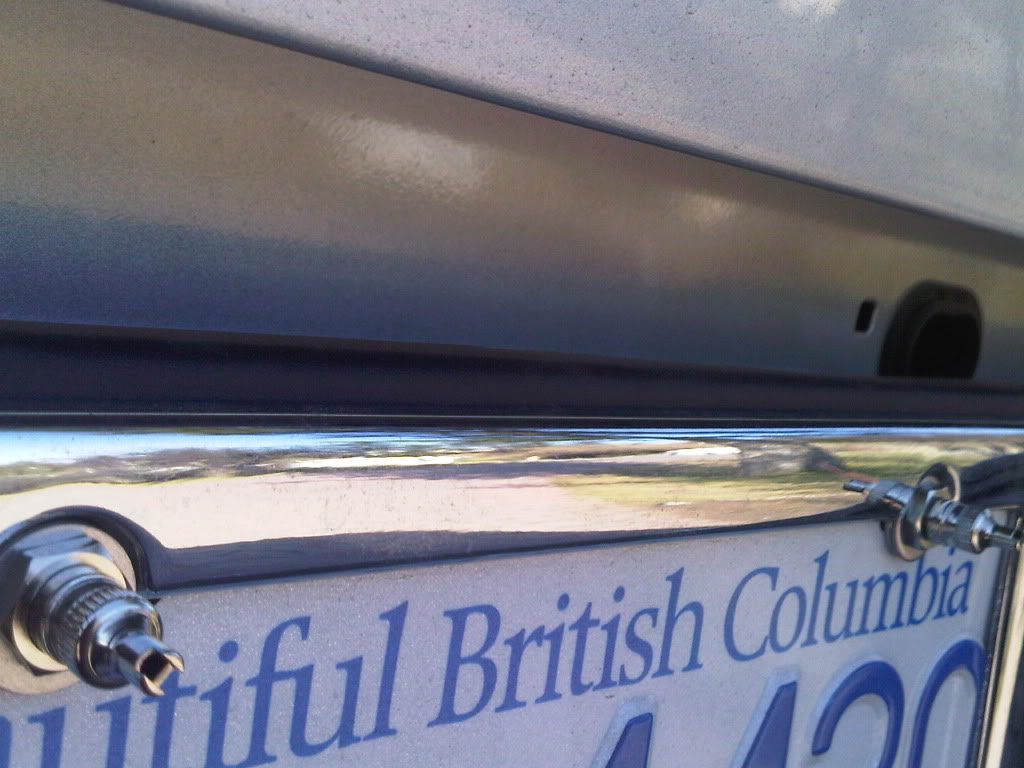

Ran the lines up through the holes and put it all back together. Then ran the lines to the back off the truck and picked a nice unobtrusive spot to mount the fittings.....

Now those ones go in easier, no removing the spring like the Air lift ones. I like that. Where do we get these?

For future reference, jacking under the pumpkin on a truck that weighs almost 3 tons is a good way to bend the housing. Take the time to lift each side seperately.

what is you have 2 jacks? LOL I was reading the instructions for installation and it requires the spring to be pulled out at least on the top, how did you do it without or did I miss something. Which model number do you have 4185?

I put the Firestone bags in my 1500 about two months ago and the installation was just as easy as yours, about 1 hour. I also mounted the Schedar valves in the license plate. Very inconspicuous.
The axel tubes on the newer trucks can bend if you jack under the punkin. Not recommended.
Seriously? Wow...... never would have thought they were THAT weak..... I guess I am used to the good old corporate GM 14 bolt FF's. Never had a half ton before. Thanks.
I will have to check on the model number. My instructions say to do it exactly like I did. They did say to gain more room, you may have to remove the shock for more droop, I did not.
