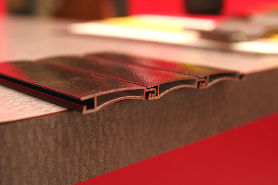

Sample cross section of Truck Covers USA cover showing interlocking double walled aluminum slats. It's very strong.

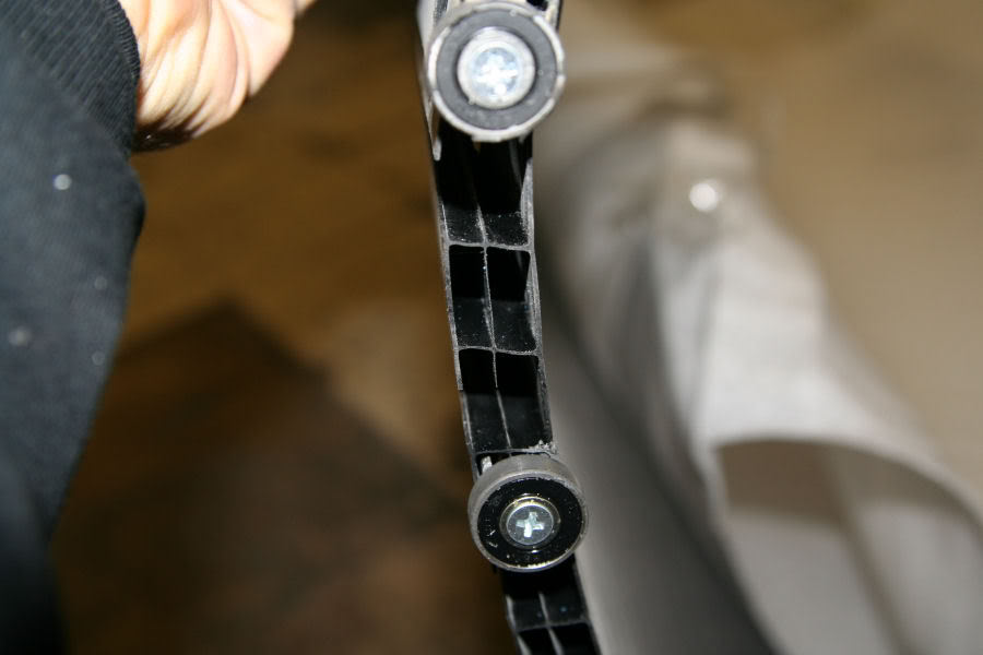

The Retrax curtain from the side.
Inside the Retrax canister. The curtain does not roll up upon itself (which is a good thing).
