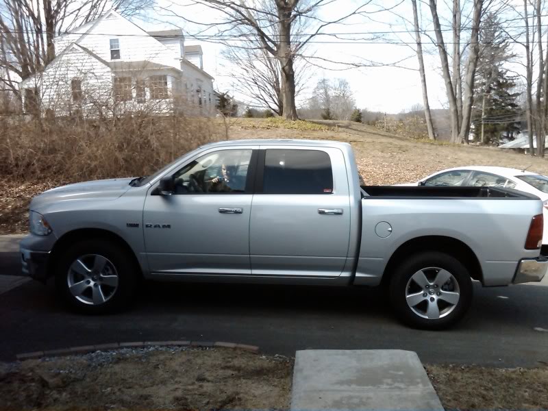

Hi, I have a 2010 Ram 1500 Laramie and have had a vinration around 60mph since new, thought maybe it was just tires so i have driven it now for a few thousand and still have a vibration, brought to the dealer and they tried a new rear driveshaft and balancing rear wheels but sis not help, am bringing it back to try a front tire balance but it really doesn't feel like its coming from the front, anyone lese had a similar issue??
