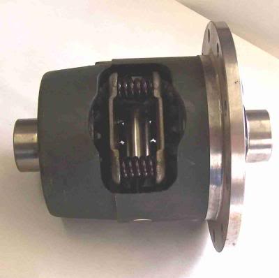

And ours do not have the "clips" that came out in earlier models
ARVADA.....was this an open rear end or LSD???
