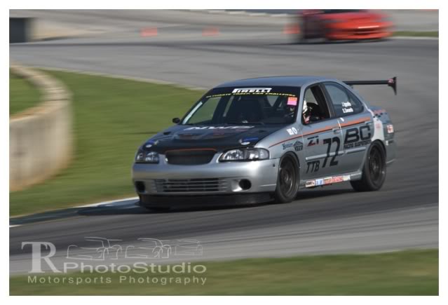

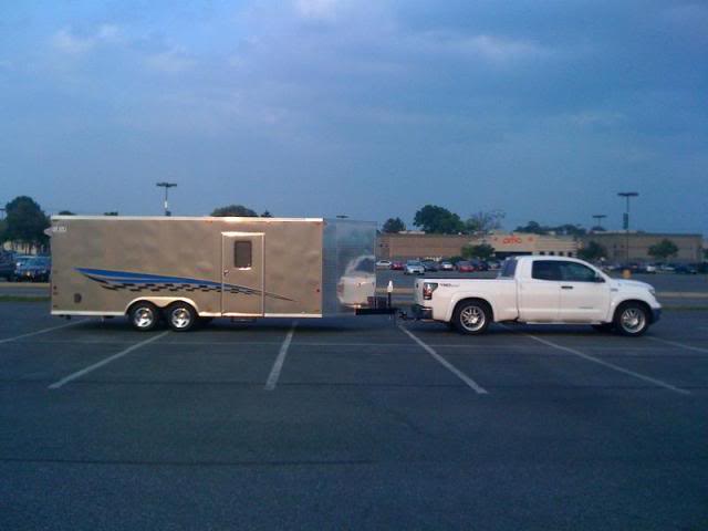

My first post I currently have a 08 Tundra 5.7 and tow a 20ft Vnose with a VQ (V6) powered SE-R in the trailer (6500lbs). The Toyota is nice but it rides like absolute garbage. My wife wont even ride in it around town. Granted it came with the TRD sport suspension from the previous owner, which simply intensified the poor handling.

2. Will I need helper bags for towing 6500lbs? I had them on the Tundra. I use a WDH with sways so I can level the truck using the WDH. Wondering how well this new rear suspension holds up to towing.

I can't help you with the camera question, but I think I can give some input in about the air bags. I think that air bags is a great idea to keep your trailer stable hitched up to your new Ram. A WDH is great, but can only do so much to keep the load stable. Air bags and a WDH is the way to go IMO. With the new coil spring suspension not being as rigid as leafs, any extra support is a good idea.

I have a 16' V-Nose, 3.55 gears, and 4" rear drop. When I hook up, I'm on the rear bump stops. I plan to get some helper bags but the enclosed trailers have a heavy tongue weight. I've towed mine empty (just bought it Labor Day weekend) 350 miles and at 75 mph I averaged 9.5 mpg, at 65 mph I averaged 11.5. The Hemi tows it fine but likes to rev.

My Tundra was lowered and was on the bumpstops as well when I towed. I added helper bags b/w the axle and frame, but it made the ride worse. When the truck was unladen, the helper bags removed all remaining clearance b/w the axle and frame (even deflated) and it felt like I had a solid rear axle with zero dampening. Unfortunately I learned the hard way (on a Tundra), you cant tow with a lowered truck.
