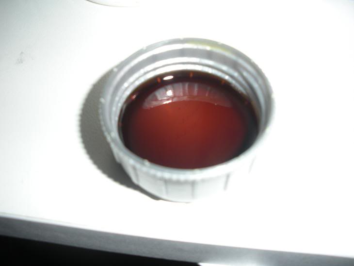

I'd be really interested to hear about how much oil you're getting into your catch can over a period of time and miles, and whether you're seeing a drop in oil level on your dipstick that's comparable to what's showing up in the catch can. I'm thinking that a relatively small amount like your pics show wouldn't be noticeable on the dipstick, but over time it might be. There's probably more than a few others around here that would be interested as well.
I've been kicking around the idea of what to do with the oil that ends up in the catch can. I'm thinking that since it came from the engine and it's very unlikely that it has been contaminated with anything, it should be ok to just pour whatever's in the catch can back into the engine whenever you need to drain the catch can. I guess the other option would be to dump it into a container and take it to a place that takes used oil, but I can't really see how it would hurt anything to pour it back into the engine.

I've been dumping the canister everyday after work. It this pace, it looks like I might fill the cap of a mobil 1 quart bottle after 5,000miles.
Picture at 350miles
