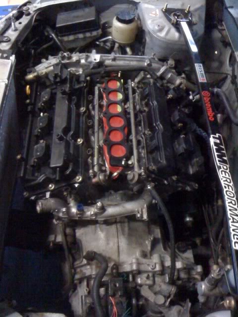

I rebuilt a V6 from a 350Z, built the mounts, rewired the harness to accept the CanBus and wedged it into a Sentra - this diff wont be a problem.
